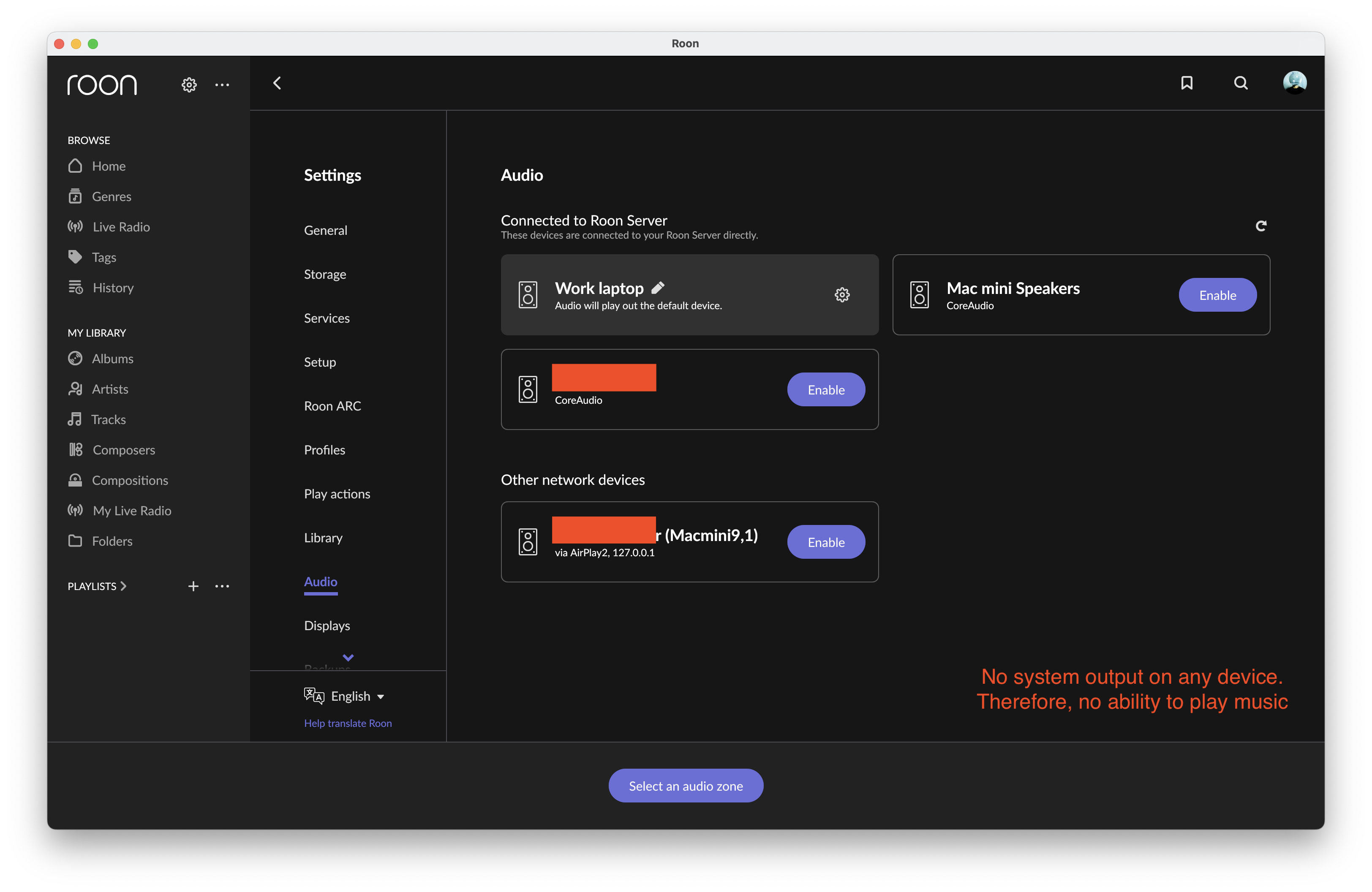

Actually you know what. All of the above is wrong.
See my screenshot… the issue is actually that there is no “This Mac” section.
Local device discovery in Roon goes through the network layer as well, as far as I know. Which makes sense to keep it simple and not have two code paths for remote and local devices. But I can be wrong.
I thought you had said that it worked after toggling the switch. Did it not?

@Suedkiez right so, I was rushing - basically I had Remote Desktop’d into the Roon Server. And the music was playing through that. I just figured, since I could hear music, it was sorted.
@daniel set up is 1 Mac mini Roon server, 2 mbp laptops. Very basic, nothing special in terms of network config. As per above screenshot, no local devices showing

FYI I uninstalled roon with brew and re-installed it. And the This Mac section is back now.
Hi @amk221,
Sequoia’s tighter network security is policing the interaction between coreaudio and Roon’s loopback connection. Toggling Local Network access On/Off for RoonServer might continue to resolve the issue if you lose all local Zones on a MacOS 15.x machine. Restarting RoonServer or the machine might also help.
We’re investigating here: Roon on MacOS 15.0+ Sequoia: Audio Zones Disappear, Requiring Local Network Access Reset/Restart [Roon Investigating]
