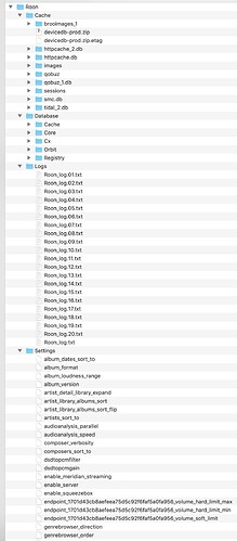

TBH I have no idea, not the layout I was expecting to see, I was expecting to see two folders called ROONServer and RAATServer and in each of them would be a log folder.
I don’t use Roon on a Mac so it may be worth waiting for a Mac user to chip in.
Thanks for the help. I did a search for RAAT and ROONServer files. The computer does not find them. Have a nice day :slight_smile:
Think I’ve twigged it.
Open finder and then make sure you hold the ‘option’ key and select the Go menu and select Library.
You should then be able to see a folder for Roon and RAATServer, I guess the ROONServer log is in the Roon folder on a Mac called Roon_Log.txt
Thats’ right.
