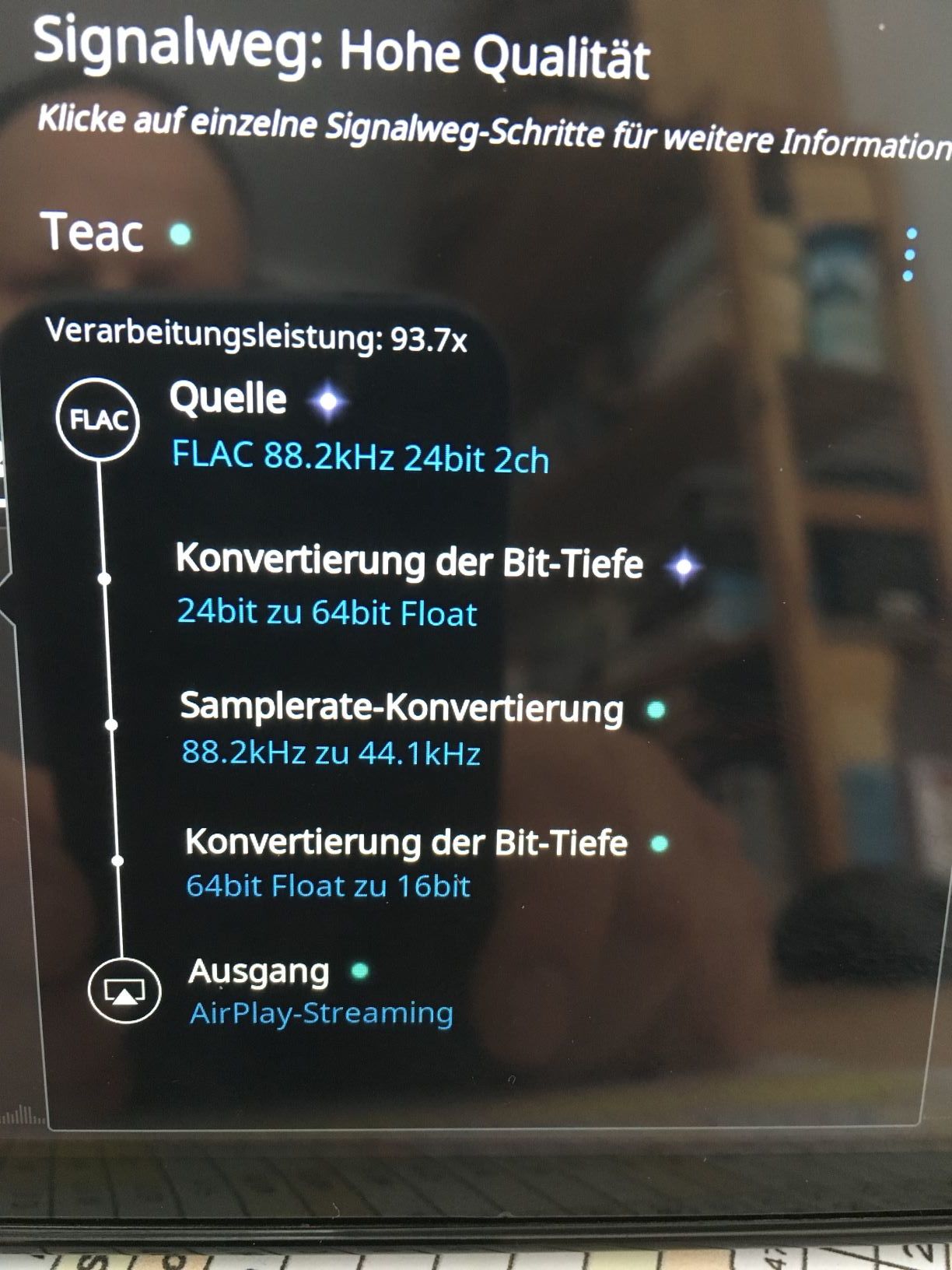

Here you can see how a hires file is down converted for the Teac, because the Teac is only detected as Airplay device and not Roon Ready how it should be after upgrading network and device firmware.
