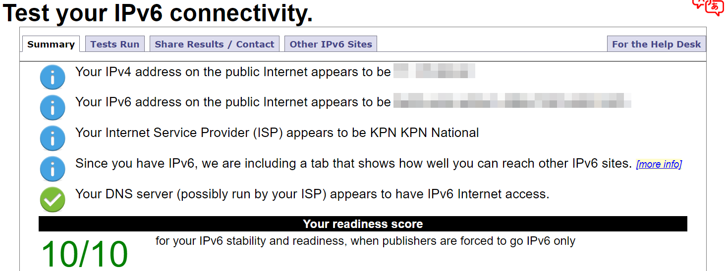

I tried all commands, the response is what you would expect and show that IPv6 is functional.
My mobile provider is the same as my fiber provider, both are full dual stack IPv4/IPv6.

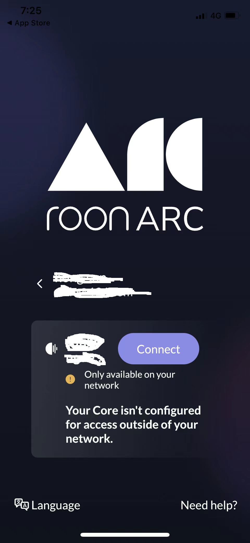

Upgrading to 1272 on Roon, the Roon Arc on Roon Core is finally ready.
But the mobile phone’s Roon Arc, iPhone, and Android clients cannot be connected, as shown in the figure.
What internet are you using? I am on T-Mobile home internet and it doesn’t work still.
And, it won’t because Tmobile has blocking that prevents ARC and things like it from working.
