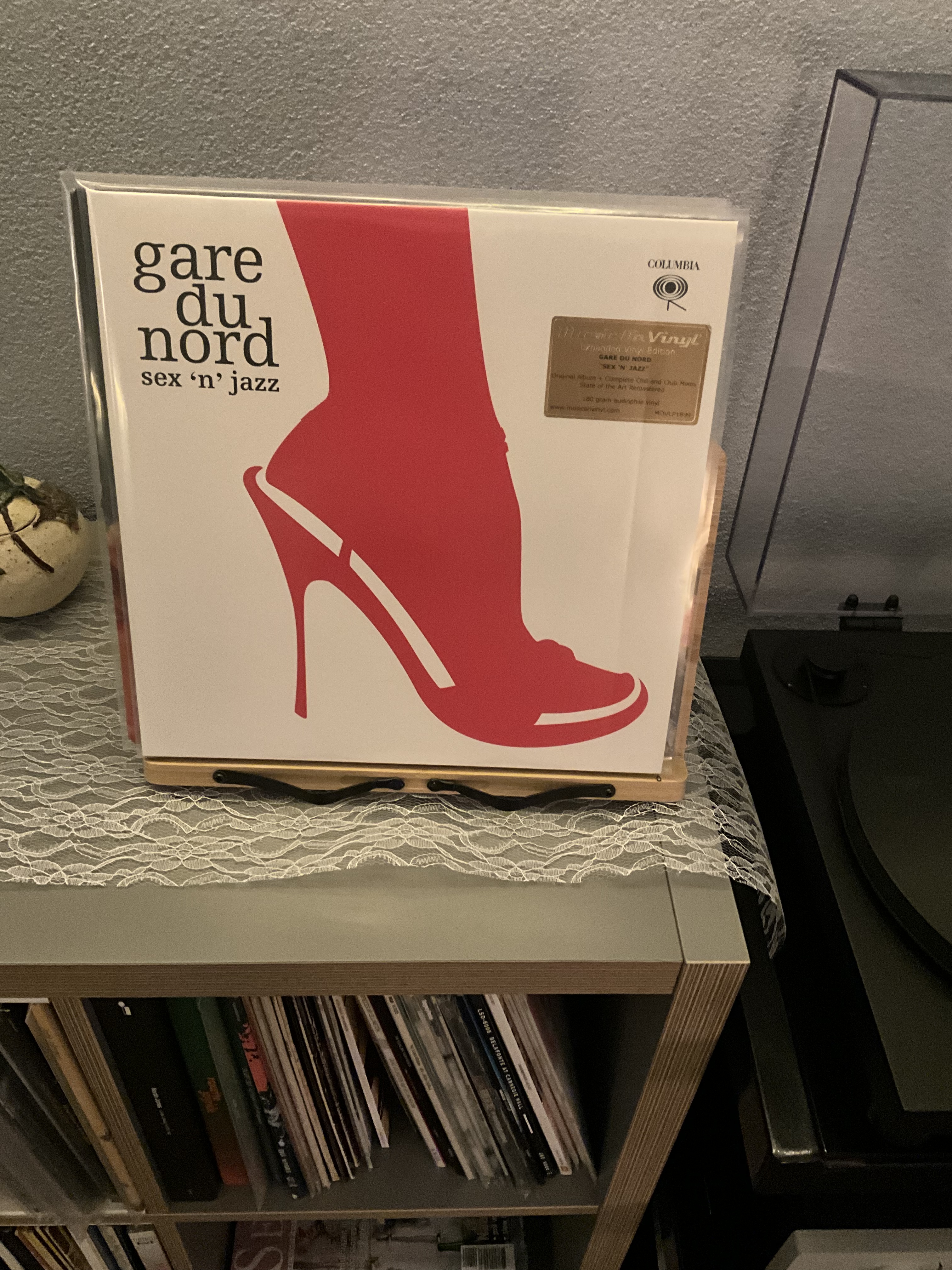

Just came today. I’m leaving it wrapped while the fish bid it up on Discogs. Someone just paid $160.
