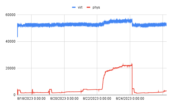

For reference, here’s the output of a script that records logged physical and virtual memory, showing the big blow-up a few days ago. Each drop to baseline is a reboot.

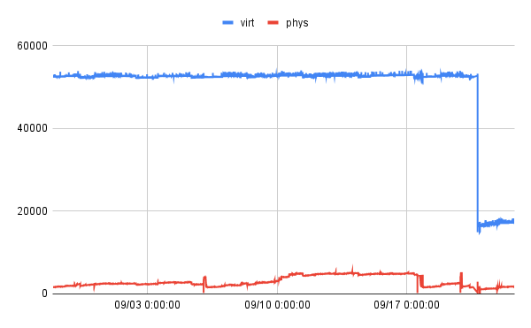

Graph from my memory script (Ubuntu Server 22.04.3). The big VM drop is after the update. There were several reboots along the way as I updated Ubuntu.
