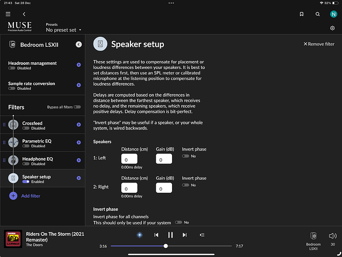

I’d suggest that different devices will take different amounts of time to process the signal, hence the delay. I can’t see a way in the Kef app or manual to adjust the delay but this Muse screenshot might help -no idea but worth trying. Obviously just adjust the sync on one of the 2 destinations. A good way to test the sync is play a sine wave and adjust until you don’t hear any ‘beating’, then try some music. Good luck!

You should only group devices using the same protocol. Roon RAAT does an excellent job of keeping different zones in sync, but AirPlay will not deal with latency so well.
Speaker setup is not intended for this purpose, and should not be used in the way described.
I can’t group my older HomePod with other non Airplay devices - but if the OPs system allows him to do so, it would be helpful to know the reason why using speaker delay on one of teh destinations is a bad idea. I’ve noticed different DACS even when fed simultaneously by the same usb soure have different propagation delays and for A/B testing it would be good to have them in sync. I haven’t used speaker delay for this purpose- but I was hoping to give it a go. Thanks
