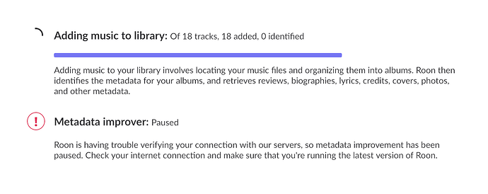

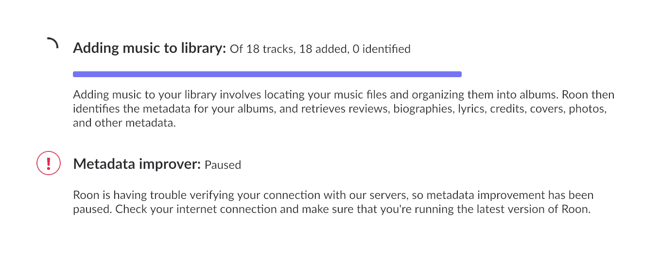

It may be unrelated, but I am also seeing this message consistently in the Roon UI:
It never manages to identify these 18 tracks (but the number changes occasionally). This has been going on for days.
But I don’t want to make this into a two-issue post - my main concern is the track skipping.

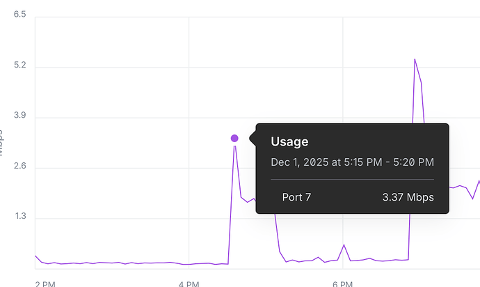

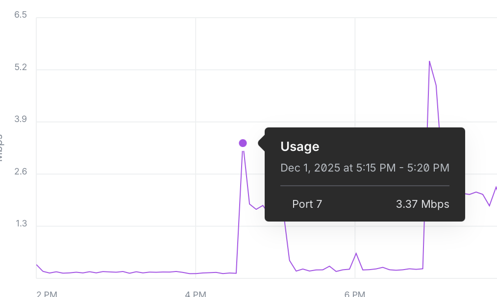

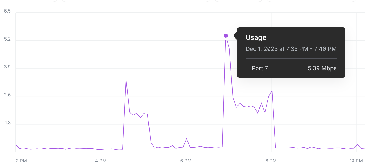

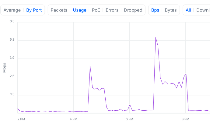

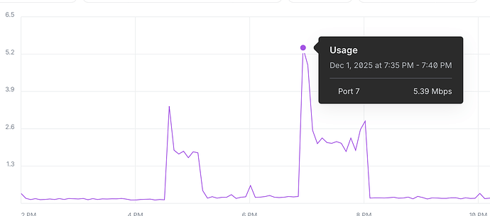

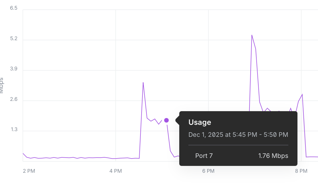

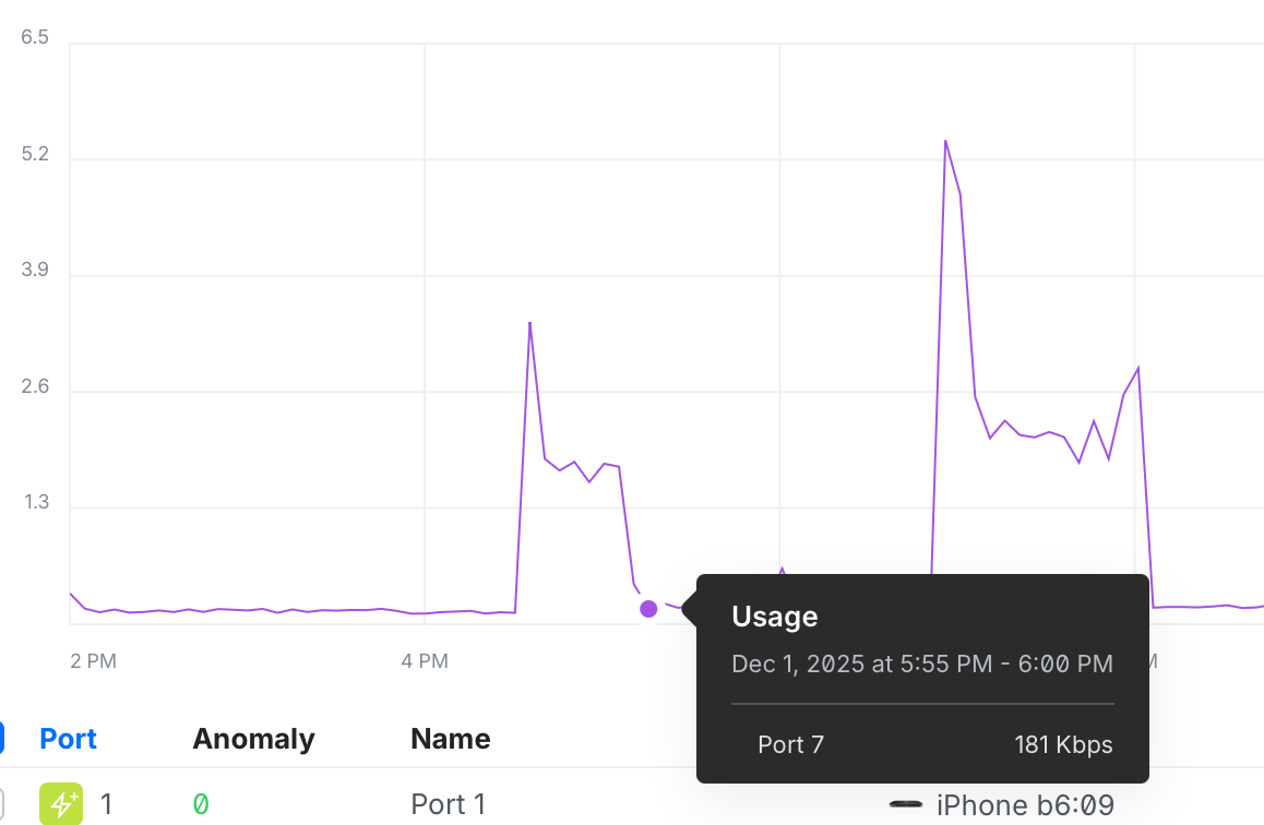

This may be of interest - before the skipping, the NUC/ROCK seemed to go out to the internet and download a lot of data:
The data download appeared to start around 17:15 - 17:20 (the data presentation here is averaged over 5 min periods)
Then started dropping between 17:45 and 17:50 - exactly the time period I experienced the skipping…
And by 17:55 it was back down to its base load and just ticking along until the next, even bigger download spike
The next download spike started around 19:35 - 19:40.
Speculating - could it be that there ROCK has gone off to the internet, downloaded a lot of data and then around 17:45 started some intensive processing of that data?
That’s an awful lot of data being downloaded - 1.76MegaBits per second average for around 30 minutes total implies around 400 MegaBytes in total. And then even more a couple of hours later. What is it doing?
If that processing had overloaded CPU or memory or I/O internally, it could conceivably have resulted in the skipping. But I don’t think I have access to this level of internal logging to be able to check this…

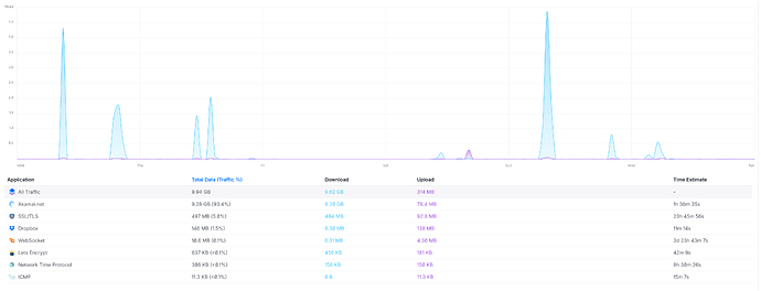

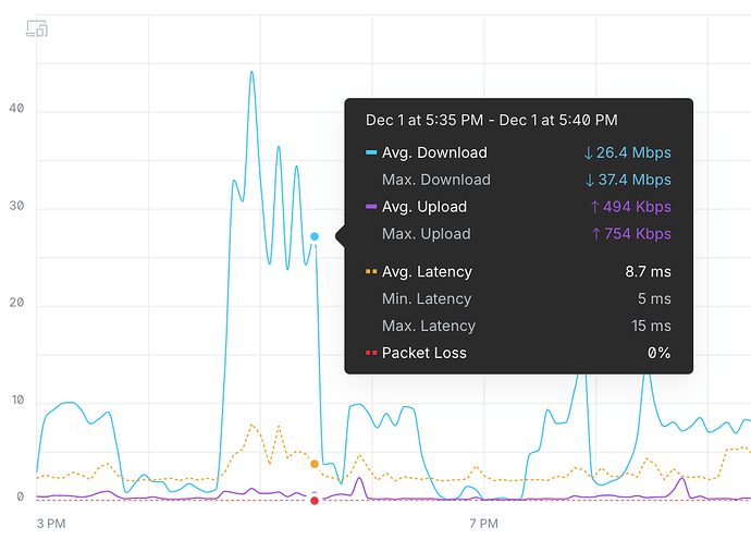

By the way - to be clear, this data is ONLY for the switch port the ROCK is on. There is nothing else on this port and I’ve filtered out all data relating to other ports.

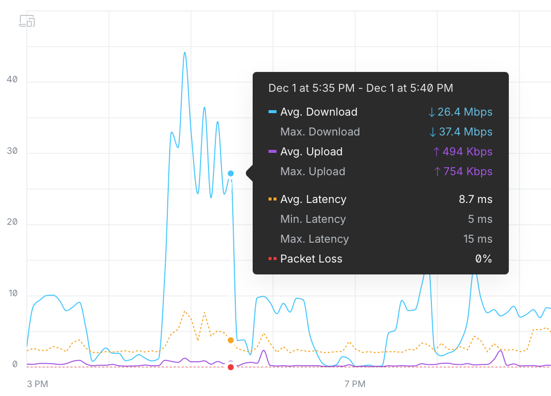

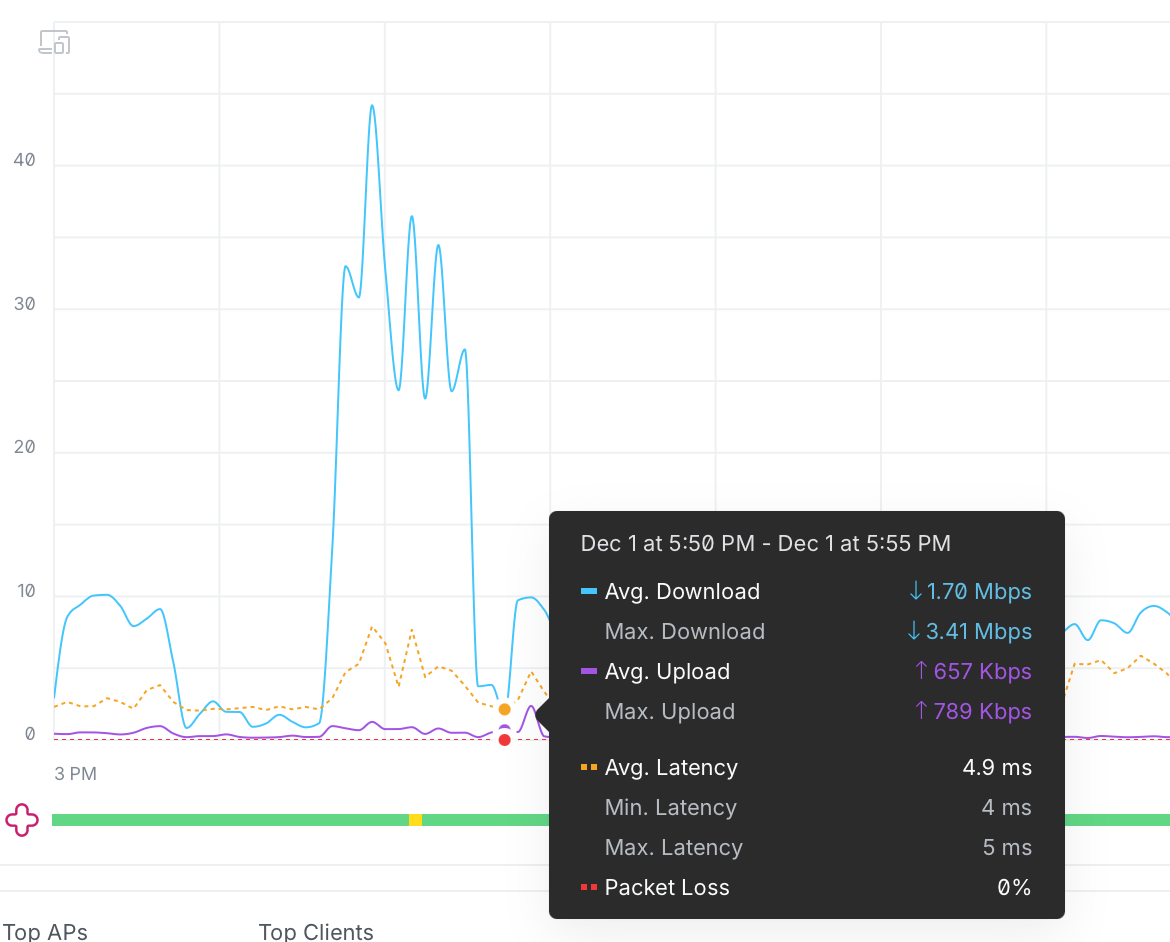

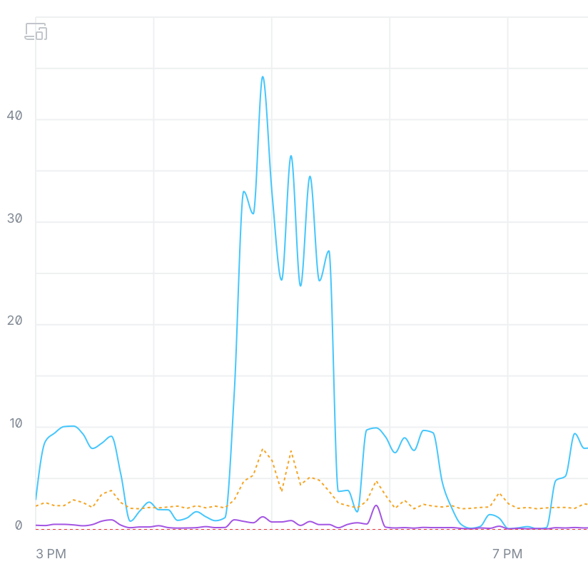

But just to put this in perspective, here is the data for ALL internet traffic in and out of my house over the same sort of period:
Blue is download. Lilac is upload and yellow is latency
The vast majority of the traffic between the ROCK and the Internet appears to be Akamai.net (85% of all traffic) and “SSL/TLS” ( 15% it doesn’t tell me from/to location for this). All other traffic adds up to less than 1% combined. The 85%, 15% and 1% are rounded numbers - hence the 101% total.
To be clear - I wasn’t interacting with either the ROCK or the Roon UI at the time. I had set an album to play about 20 mins before and was just sitting listening to it. So it appears this spike of activity was due to some sort of internal process kicking off inside the ROCK of its own volition.

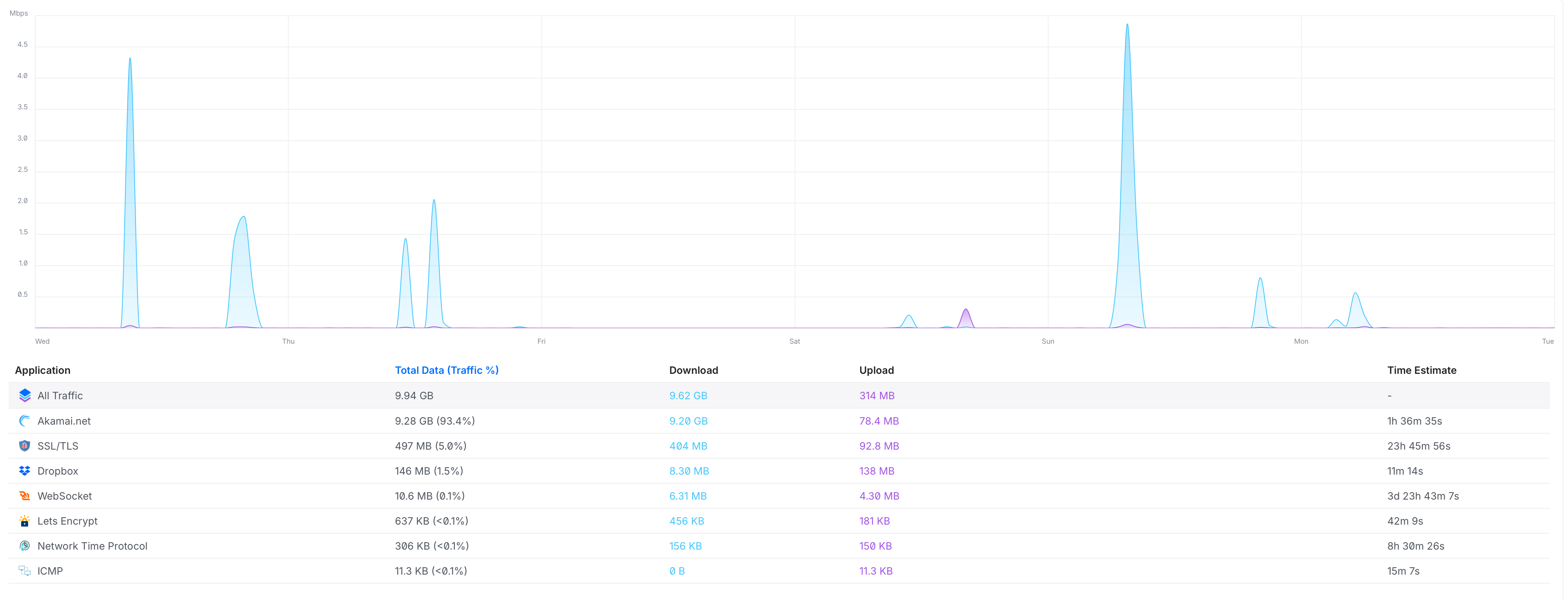

One final thing, whilst I remember. If the NUC is indeed overloading, it will likely do this on most installations, as this NUC is highly optimised for speed. It is the latest i7 CPU, with 16GB of very fast RAM, an internal V5 NVMe drive for the OS and another internal V4 NVMe drive for the music database. If Roon is overloading that, it will probably overload anything…
Here’s the traffic profile to/from the NUC/ROCK over the past week. The graph is smoothed compared to those above as it’s no longer being averaged over 5 minute intervals.
By the way - I inadvertently switched the NUC off on Friday - hence the lack of I/O on that day.

I have been listening pretty much non-stop since then. It is now 19:20.
I’ve left music playing on the WiiM Ultra using Roon Radio - which I think should keep it going pretty much indefinitely? The volume on the WiiM is muted (Not paused - I’ve confirmed the music progress timer is progressing and it is moving from one track to another.
I’m happy to leave it like this all night and as long tomorrow as practicable. Let me know when you have enough data for your needs.
I’d be very surprised if we saw any skips - if the skips really are caused by network failure/latency etc. There shouldn’t be any issue with that now. I experienced no skips at all during this 3 hour listening window. But OTOH - I’m the only person in the house at the moment. Normally, there are 5 of us and all making use of the Wifi for either work or entertainment. So the network has been unusually quiet during this time.
If, after this experiment, you want me to change the setup to establish what was going on when it was WiFi connected, I’d be happy to assist. I have extensive diagnostic data available for my network. All components of it are managed Unifi devices and report back to the management console.
Ultimately, playback over wifi from Apple Music, or Qobuz Connect, or Spotify works fine - without these noticeable track skips or glitches. So it seems something in the error recovery mechanism of Roon is less than ideal.
If the Wifi is causing these glitches, it surely must be doing so in the case of all the other streaming protocols. But they recover from it in a manner that is not as noticeable or irritating as the way Roon does it.
It would be good to assist Roon to get to a similar level of user experience in this matter - as it is way ahead in user experience in most other aspects…
Some further thoughts on why Roon’s error recovery here is less user-friendly than some others:
It appears that, on detection of connectivity issues between Roon Server and the Roon endpoint, the approach has been to skip to the next track. This seems to be an illogical response to the issue for two main reasons:
  1. Then issue isn’t with the source track being played (this approach would be logical if the file being played was corrupt or inaccessible - but that’s not the case here)
  2. This approach is likely to make the problem worse - skipping will tell the end point to discard all or much of what is in its buffer - resulting soon, if not immediately, in a need to send yet more data over the problematic connection.
There is potentially another issue here:
The the only time the Roon endpoint needs to stop a particular track playing is when the end point runs out of data in its buffer. With a big enough buffer, it could keep playing for minutes - or longer - without any further refresh from the server. Yes, this might play havoc with attempts to synchronise playback between different endpoints - and yes, it may make the endpoint unresponsive to pause/skip commands from a remote UI. But I - and I think most people - could live with the UI unresponsiveness in preference to this skipping approach. The synchronisation of multiple endpoints is detectable - and this behaviour of letting each endpoint “do its own thing” could be changed in that case. But I suspect this synchronisation case is much less common than the independent end point case. and people doing “critical listening” are probably listening to a single end point.
So - if my analysis of what is happening is correct - my proposal would be to change the recovery mechanism to address the actual problem being experienced. In this case, allow the end point to pause itself if it runs out of buffer and signal that to the server (and signal when it’s running low on buffer - although I imagine it does that already).
The system should not be trying to skip to the next track in response to a comms link failure. That response is only valid when the current track being played is definitively inaccessible - which is not the case here.
