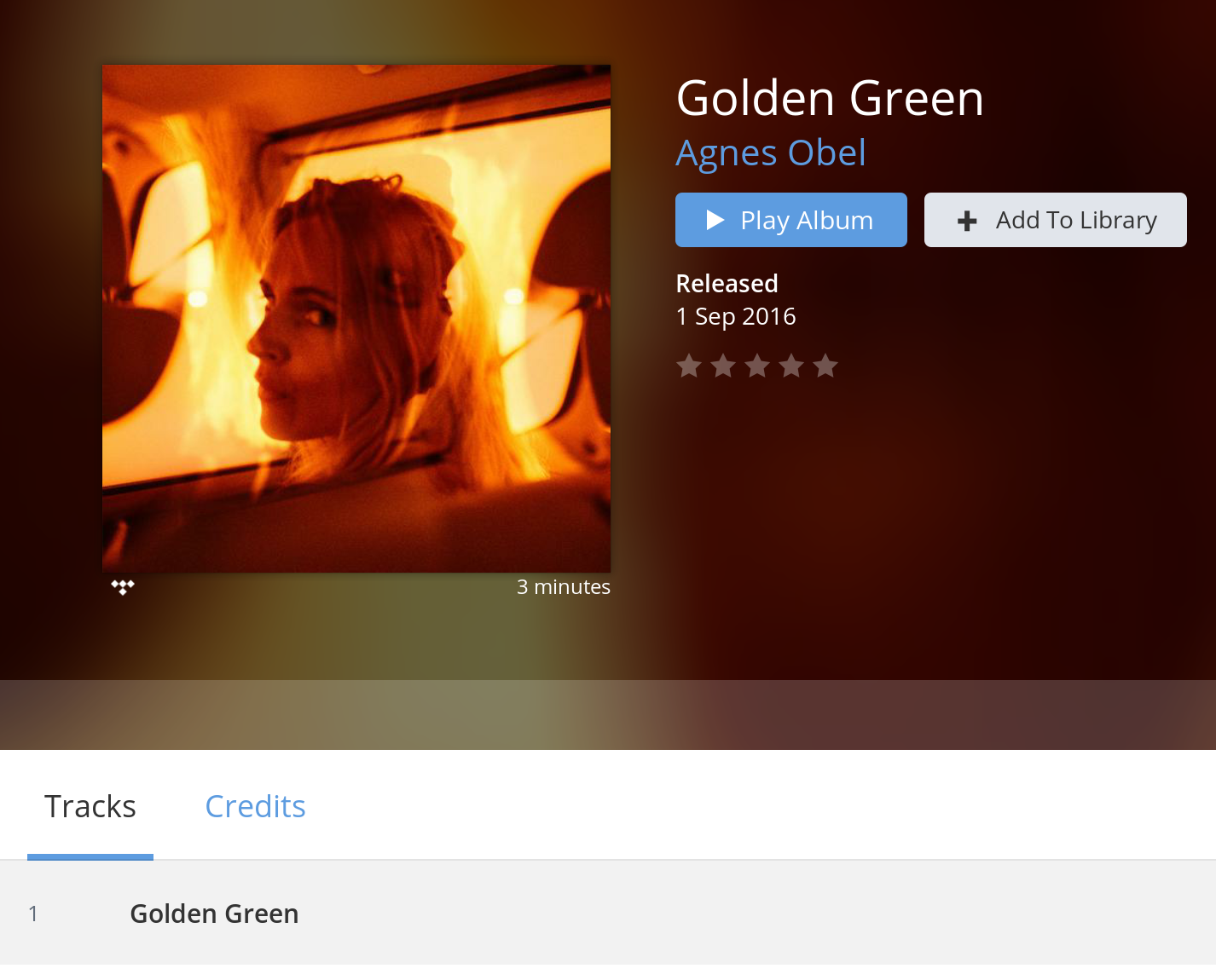

How is this possible?
the track shows up un Roon but is “unavailable” yet it plays fine from within Tidal app. so this is not a regional thing

Maybe it has something to do with the release date? For me, Sept. 1 2016 is tomorrow. It maybe the data for that has been ingested by Roon but the authorized to be played indicator has not yet updated in some syncing process?
I often see “unavailable” tracks or albums but then they’re also not available in Tidal (the entire ECM catalogue for example). But it’s the first time I see it on a track that’s actually available in Tidal
I’ll check again in a day or so and see if it becomes available in Roon
I have run into this situation more than once. Unavailable on Tidal via Roon but available (and streams) via Tidal app. Since the title wasn’t the most important thing I was planning on listening to, I just moved on to the next thing figuring it was Roon’s geo-availability data being slightly off with Tidal’s geo-availability data and it will get fixed eventually.
I will do a better job reporting these when I find them.

This is not an issue of getting an error message. I cannot even start playback at all. See above photos by original poster
Roon simply displays the word “Unavailable” (in red) above the track, in the exact same way that is does if, for example, a drive that contains your music goes down.
