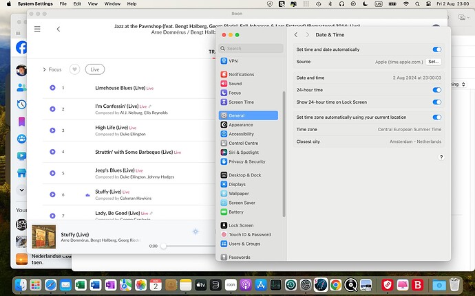

Hereby two screenshots from two songs where it happened I started with the song Jeep’s Blues (Live)
A few seconds later without playing it changed to the next song.
In the date & time window in both pictures you’ll find the time of trying it to play.
