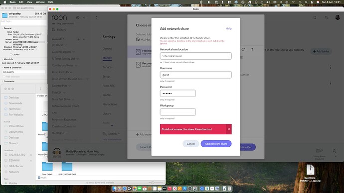

My music is stored on a network share (on an Innuos ZenMini) and Roon will not let me access it.
EE WiFi 7 Router, Ethernet and WiFi, Netgear and TP link ethernet switches, Synology NAS and Innuos ZenMini connected by Ethernet. Roon Core is M1 MacMini running 15.3.2 (24D81)
The crazy thing here is that I can easily access the 2 network shares I have my music stored on via my home network on ANY other device including: Windows Laptop, Mac Mini Finder, iPhone File app, Plex, pretty much anything. Just not Roon of course!
In the network share location field, you have entered \\ZENMINI but you have not entered the name of the share on the zen mini device.
The share location should, as the example text immediately below suggests, look like ‘\\<host>\<share>’. In your case, is ‘ZENMINI’ so it should look like ‘\\ZENMINI\<share>’

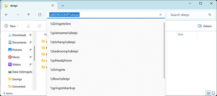

E.g for a share created on one of my Raspberry Pis:
On clicking in the address bar (but not the text within it) I get:
The selected text in blue ‘\\BEDROOMPI\dietpi’ can then be copied.
Note: If you just enter ‘\\ZENMINI’ in the windows explorer address bar, you will see a set of (1 or more) folders representing the available shares on that machine:
e.g. on the same device as above (which only makes one share available), the share name is ‘dietpi’:
Thanks for the reply. However, it makes no difference. The screenshot I sent was just one example of the many different entries I’ve attempted over hours of messing around and reading various support instructions. It just returns the same exceedingly unhelpful error every time.

Hi, Thanks. Yes. I am aware of this. I have been using the correct credentials. However, this is not an Innuos issue. It is a Roon issue.
I have just removed the network share folder for my Synology NAS from Roon (that was working perfectly only a moment ago). Just to see if I could add that back and alas, I cannot.
So now I can’t add either network share folders on the Roon Core that is running on the very same Mac that can easily navigate to both network shares. I just cannot understand why Roon is so user-unfriendly. As mentioned, my Windows laptop can also see both network shares. As can my iPhone. It is just Roon that refuses to connect.

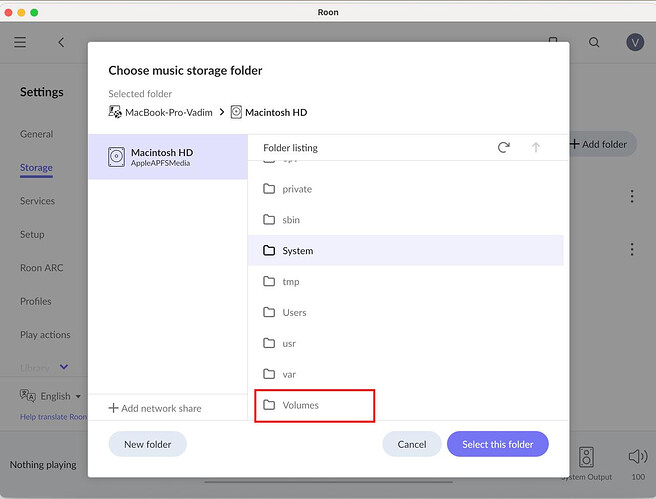

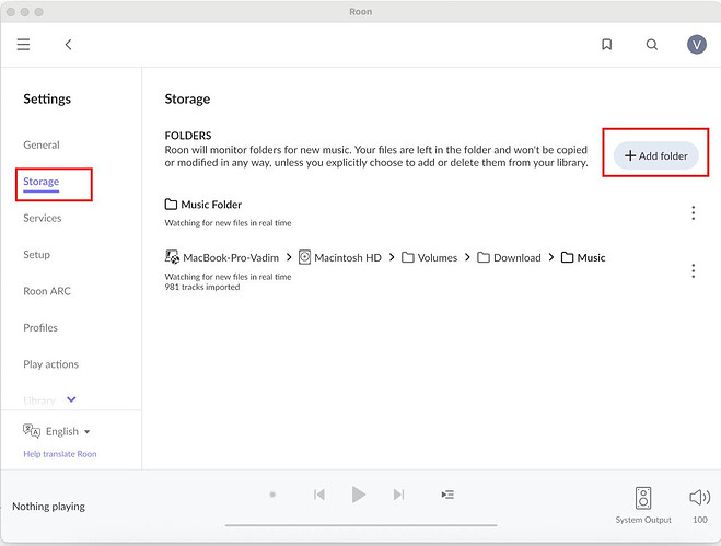

When selecting /Volume/music, this refers to a local folder. To add it, follow these steps:
SettingsStorageAdd Folder → Use the Up arrow near the folder list to navigate back to the root directory → VolumesmusicSelect Folder.
You can test the local connection first. If you notice any performance issues, we recommend using a direct connection to the NAS shared drive via the Roon application for better stability and performance.
