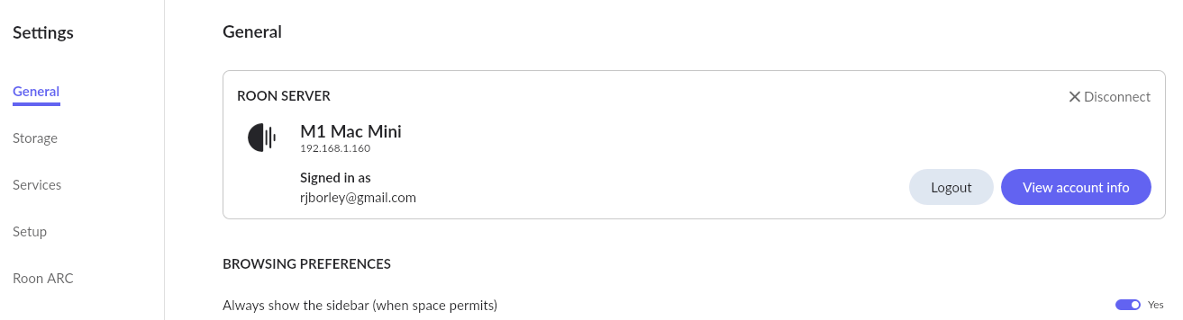

I think I will try something else, but I may also need some help. I am going to switch my Roon Core from my Mac Mini to My Innuos server. However, I think I will loose all my listening data etc. How do I move my Roon database?
I have configured my Innuos as a Roon Core and updated the Roon Core version and databases. I just attempted to restore the latest backup. However now I just seem to have 2 Roon Cores on my Mac. I am using Roon on my Mac to attempt to do this. Does anyone know what I am doing wrong?
I think I may have figured it out. Now I think I need to rename my new Roon Core. Does anyone know how to do this?
It appears to be the correct Roon Core according to the network location and IP address. However, it is called M1 Mac Mini but it’s running on my Innuos server.
Go to Roon’s
> Setup > Roon Server name and choose your new name there.
