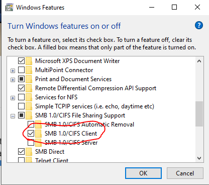

I had to go to windows features and enable smb 1.0 cifs client under the smb 1.0 protocol to get the ROCK to show up and be accessible for file sharing to work.
Someone else may have other ideas on how to get this to work but this is what worked for me.
Some may says it is a security risk so you could turn it on the get the file installed and then turn it off once done?

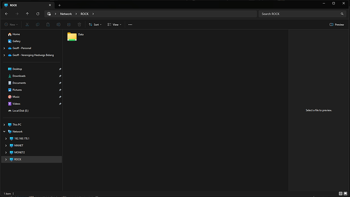

Windows has a habit of not seeing non-Windows devices in the Network section of File Explorer. Try typing in \\ROCK\ in the address field to see if you can kick Windows awake…
Example:
You might want to add \\ROCK\Data\ as a network location - Windows seems to keep that in its memory…
It’s not necessary to add SMBv1 to Windows - ROCK knows about SMBv2. The problem lies with Windows, but there are workarounds as I show…

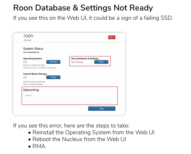

If the Web Administration Interface of your ROCK device is not showing a proper IP address (like the screenshot below), then it is a sign that your m.2 SSD in your NUC is failing. Best to replace it and reinstall ROCK, but you could try reinstalling RoonOS first…

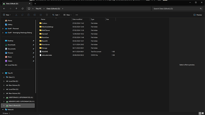

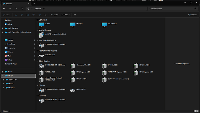

Yep, just tried it without smb1 but with the “\\rock\data” and it works, where “\rock\data” does not work. Although without smb 1 the rock does not show in “network” in windows explorer where is does show if smb1 is enabled. Windows, got love it???

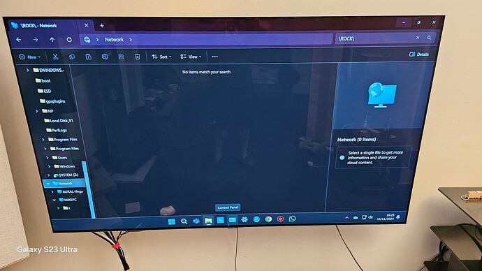

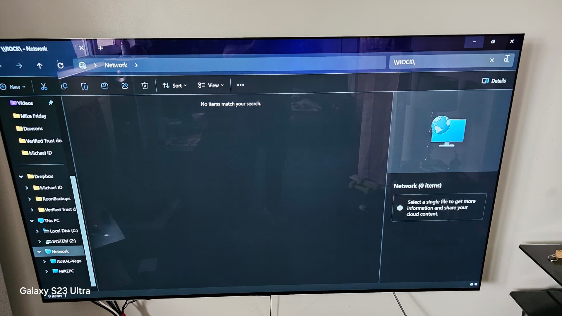

When you type \\ROCK\ into Windows File Explorer, what happens? Is there an error message? Thanks.
Just says ,no items match your search
Did that and that’s why I need to insert ffmpeg again
Well Guys I tried again,I was typing in the wrong place in file explorer,all sorted, Thanks so much for your help,much appreciated :smiling_face:
LOL, yeah just noticed you were typing in the search area not the address area… great that it sorted now.
