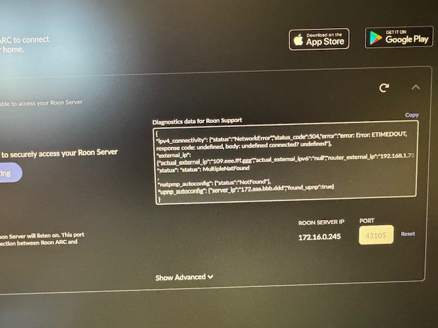

I am running Roon on a Nucleus Plus first generation and have a windows 10 machine and various Ipads I uses as an interface to access my music on a Linn Klimax system. All Wired Cat5/6 I use Arc on my phone bt recently changed to a Peplink dual router to run both BT Broadband (Open reach) and Skylink. The port 43105 is fixed on the router but am now getting ARC was unable to securely connect. I have read this could be because of the dual router trafic. So I want to adopt the VPN Tailscale option to get ARC working again.
