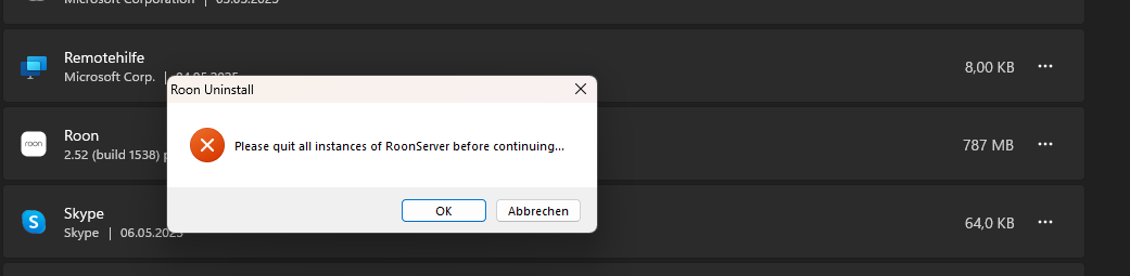

Roon Server is deleted, but:
do I have to shut-off the new server?
This message relates to the Windows Roon server, which is still running according to the message. You need to shut down the server first. Again, I believe this may be done from the task bar.
How did you delete the server?
If you uninstall Roon on the Windows PC, which is the correct way to remove it, you may then install Roon Bridge to use the PC as a remote audio device.

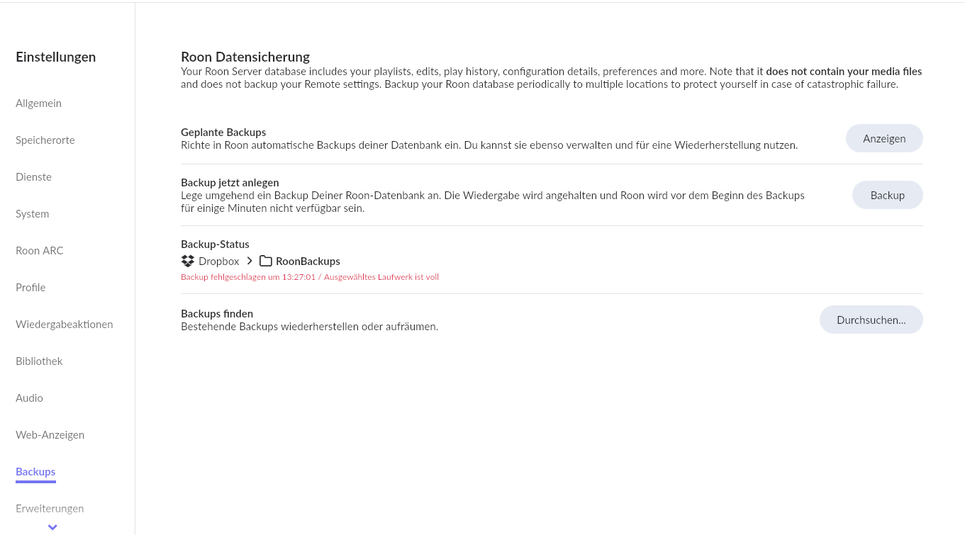

I’m sorry to keep bothering you with my problem, but it’s not solved yet. How can I use my NUC backup on the ROCK?
Where is the NUC backup stored, and was this created using Roon Remote?
If it is a proper backup created by Roon, you need to restore it by clicking on the Restore from backup link instead of logging in to the new server.
Once selected, you can browse to the backup which may be on your NAS or a USB drive.
There are guides in the help center, but I’m unable to seek them out for you just now.
the NUC backup is stored on an USB-stick, created with the NUC, while it was running as server.

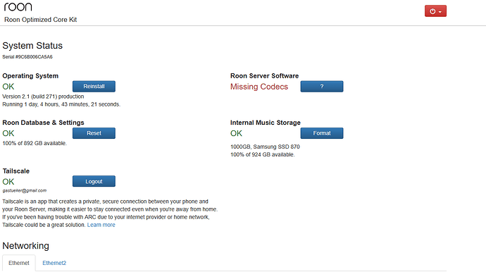

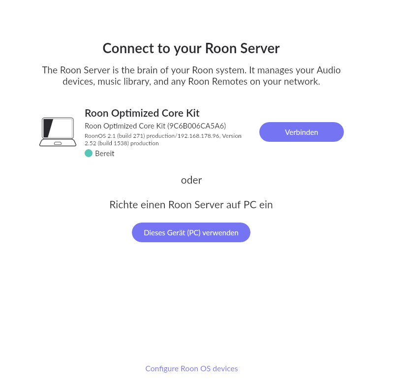

after restoring this backup (50GB) on the new ROCK (linux-based!) I can´t connect to the new ROCK as shown on the pictures.
If you open a web browser, and enter either http://rock, http://rock.local, or, for example, http://192.168.0.123, does the web interface load?
If it does, please share a screenshot.

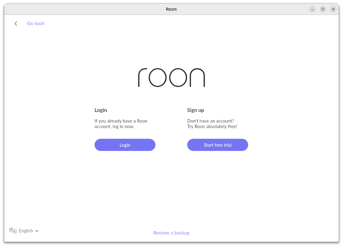

On the Roon Remote screen, logout of Roon. Then click on the new server, and you’ll see this screen.
Click on Restore a Backup.

Can you go to Settings → General, and then press Logout?
Once you’ve logged out, try connecting again. You should then see the login window I posted earlier. Next, click on Restore a backup.
