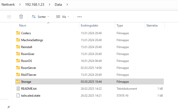

After adjusting the policy in my win.11 pc, and several restarts, it now look like this, see image.
I also finally been able to setup backup, but the only thing i’m wondering , is where my Samsung 2TB ssd-disk is, is it under storage ? I have been formatted this twice.

I have the subfolder Internal Storage, but i can’t see no size in the explorer interface
This is normal because it presents to windows as a folder - not a drive.
This is a consequence of the way that Linux manages multiple disks.

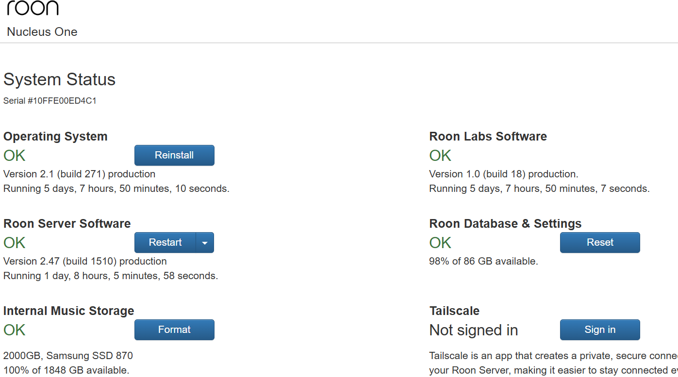

You should see the total size and percentage used in the Nucleus WebUI.

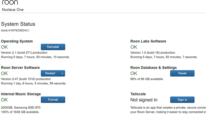

Yes, but i can see other folders size, but not this one, and the size is also important due to backup
The WebUI sucks, its so simple and gives you almost nothing, this could easy have been much better, see image:
