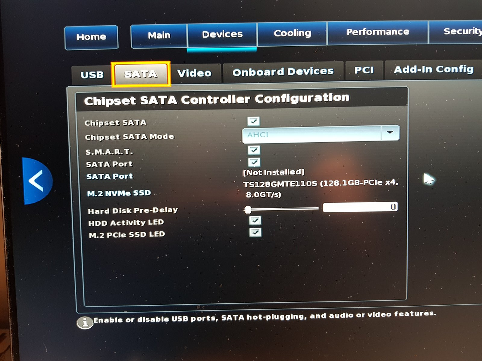

Your screenshot now shows that the installer can’t even find the SSD. Can you go into the BIOS and see if the BIOS can see the drive attached? If not, this is a hardware problem for sure (for your case at least).

I am not sure I understand… I rebooted the NUC a few times this week alone…Here is the screenshot from the BIOS settings screen, the SSD is showing there…
Funny thing is that when I reboot the NUC, I can see “Found Roon OS install #1” and “Found Roon OS Install #2” in the boot sequence… so Roon OS is there…
