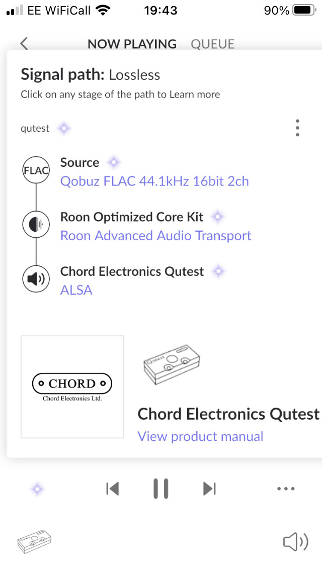

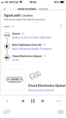

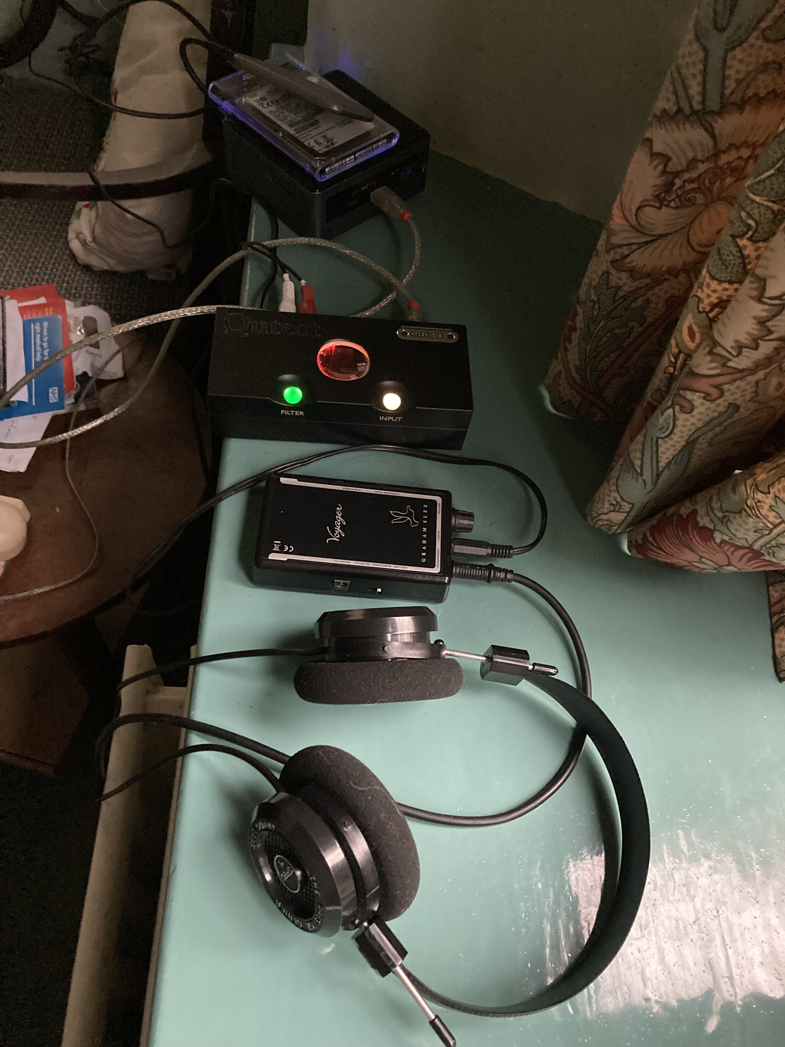

Hello Leroy,
A Chord Electronics Qutest works as you suggest, on my system.
I connected a usb cable from Roon Rock, to the Qutest, used a headphone amp into some headphones. I then used my iPhone through Roon Remote settings to set up the new USB connection. The dac appears in the audio section and all it needs is a name for the new audio zone.
Not a recommended setup, I would guess, but it does sound very good. I didn’t test the headphone socket on the Rock, I believe you.
