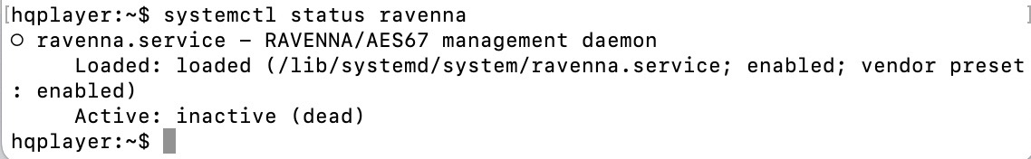

I tried to boot your hqplayer-embedded-4.35.0-x64ravenna.7z image for my Up^2 for NAA->Ravenna bridge but unsuccessful.
To disable the DHCP on both RJ45 ports and assign link-local address to one of the port for Ravenna I edited /etc/systemd/network/wired.network but always gave me DHCP address. And even use the DHCP address but the Ravenna daemon always inactive… please advise.
Guapo
Just out of interest, without using bridging (temporarily - I understand you do want this for permanent use) does it work?
Tried but Ravenna daemon couldn’t start…
If Ravenna daemon up and running you’ll see such messages:
Hi Jussi
After some study with a friend I figured out it’s the systemd/networkd setting issue and solved. Now the NAA → Ravenna is working.

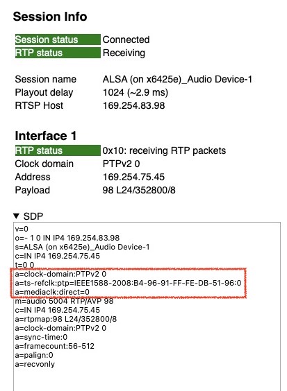

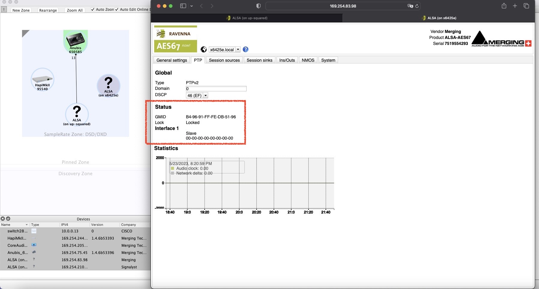

Hi Jussi
I thought if PTP clock info is not available, means the audio stream output won’t have ref clock. The sink would guess everything.
For example, if you have good clock lock status, the stream URL / media header would show like this:
That would make both side (source and sink) happy, cuz they all have a ref clock to deal audio stream.

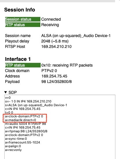

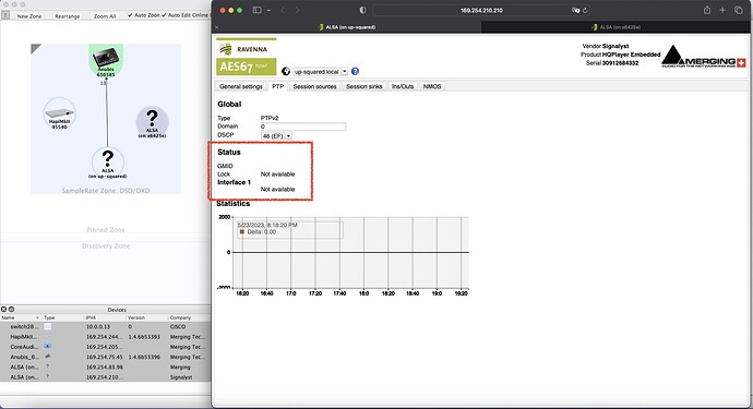

If there’s no lock info, the URL / media header would miss that part:
If ref clock field is blank we prob will see unstable audio stream. I boot your 4.35 RAV edition as NAA in fact I did meet some skipping when playback immersive DXD contents…

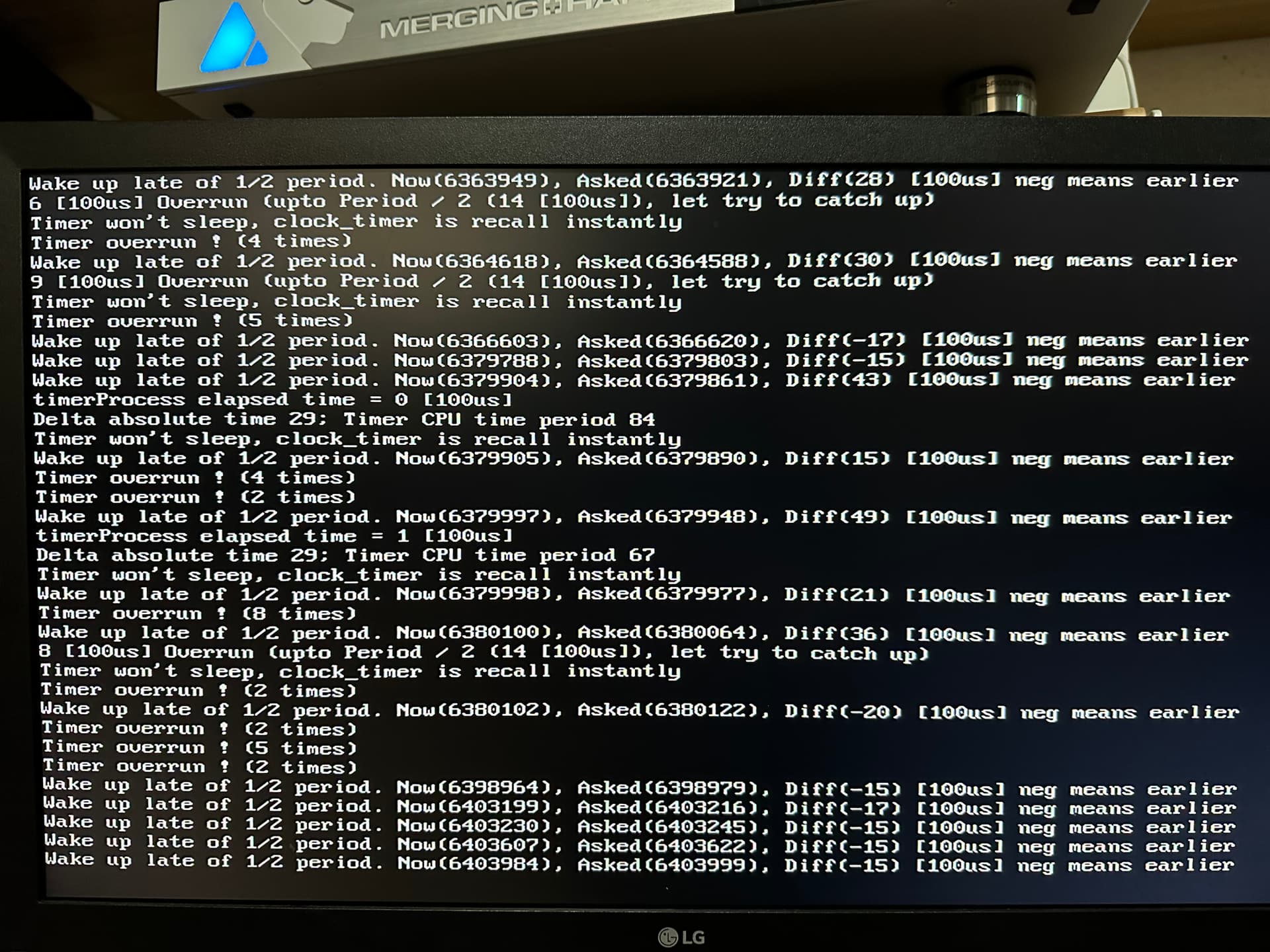

Can work but inconsistent. I ran the HQPe4 RAV edition on my new Fitlet3. Unicast blue dots intermittently changed to orange dots when such kind of messages popping out:
So I went back to my own build NAA → RAV bridge.
