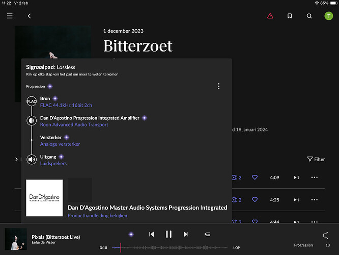

Don’t use any settings in Roon besides the +3db to the right speaker to center the soundstage.
So, if you remove the +3dB correction on the right hand speaker, does Roon report a bit perfect processing chain - at least as far as the endpoint audio device (Lumin/Progression - whatever you are currently using)?
What does your processing chain look like in Roon?

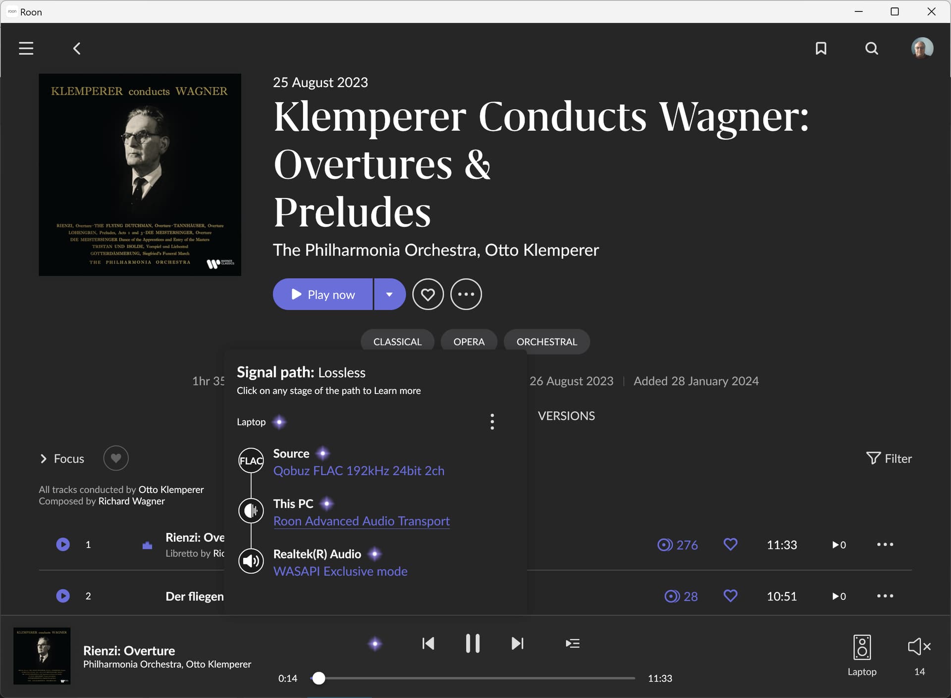

With the +3dB removed from the right hand channel, it should look like (ignore the fact that I am using the laptop as an endpoint, that is just for convienience. The important thing is that the source and the endpoint are reporting bit perfect processing [or in this case - absence of processing]):

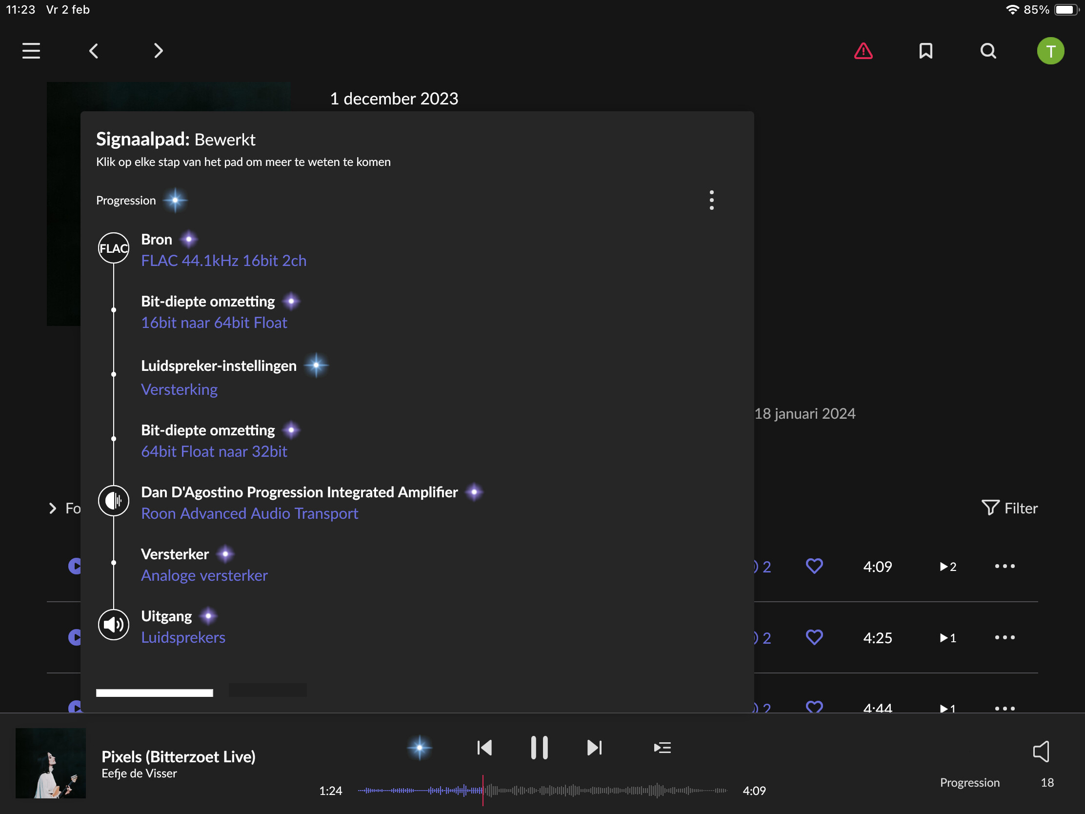

+3db
0db
Here are screenshots
Ok. Well at least that is a better workaround.

That signal path looks fine.
