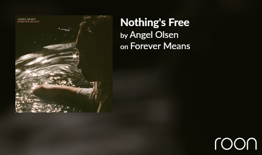

So soooooo very lush… dripping even…
RoonShareImage-638714979739891566
SDM (DSD)
poly-sinc-long-ip
ASDM7EC-light 512+fs
24576000/1/2 (DSD512x48)
T+A DAC200 (no correction)
