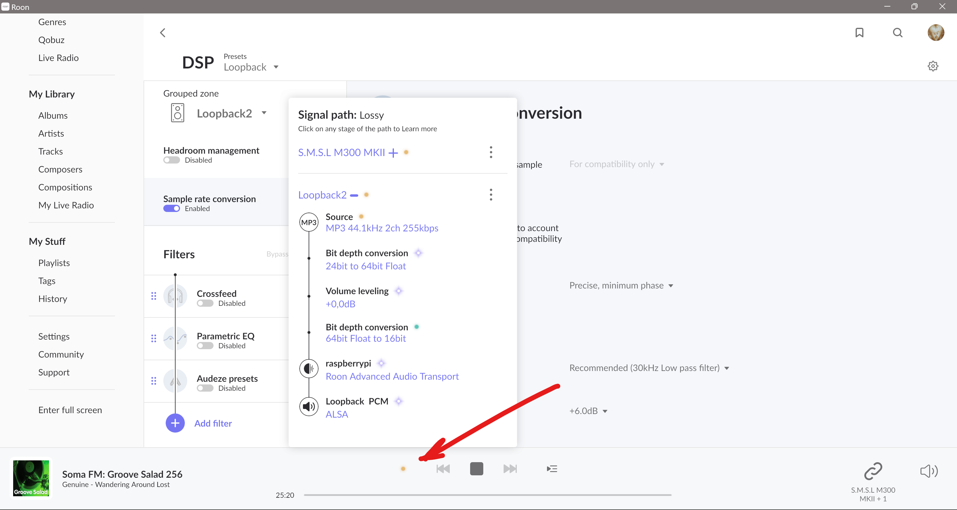

However I don’t hear any difference with this upsampling enabled.
The only thing I achieved is this screenshot that shows enhanced instead of lossless, and I got my white led turned on indicating DSD playback. Because I have choosen DSD 64 when I enabled sample rate conversion.
If I choose DSD128 or DSD256, hissing and distorted sounds appear. Why is that?
Is this setup the maximum possible quality that I can achieve from flacs and the Mojo 2?
This is using WASAPI, exclusive mode.
If I use the ASIO Chord 1.5 driver, I hear no fiffreence at all.
No matter what settings I change in Roon or with the Mojo 2 , like using te equalizer (UHD DSP control) to enable deeper bass by pressing the menu button first and then pressing the plus button until it’s red, or if I enable crossfeed, I hear no difference, even now when DSD is enabled.
How can this be?

Incidently, this is most likely an issue with your core or transport. From the signal path you posted earlier, processing speed was 1.3x, which is marginal performance for this kind of DSP.
Easy to see you issue here, your Roon core likely isn’t up to the job of upsampling to those resolutions. Look at your signal path you’re at 1.3x processing speed at DSD64 anything around that speed is in the danger areas anything drops lower you will get dropouts and hear what you’re hearing. Also when applying any DSP you should enable Roons headroom management as your also in danger of clipping samples especially if using eq of any kind.
