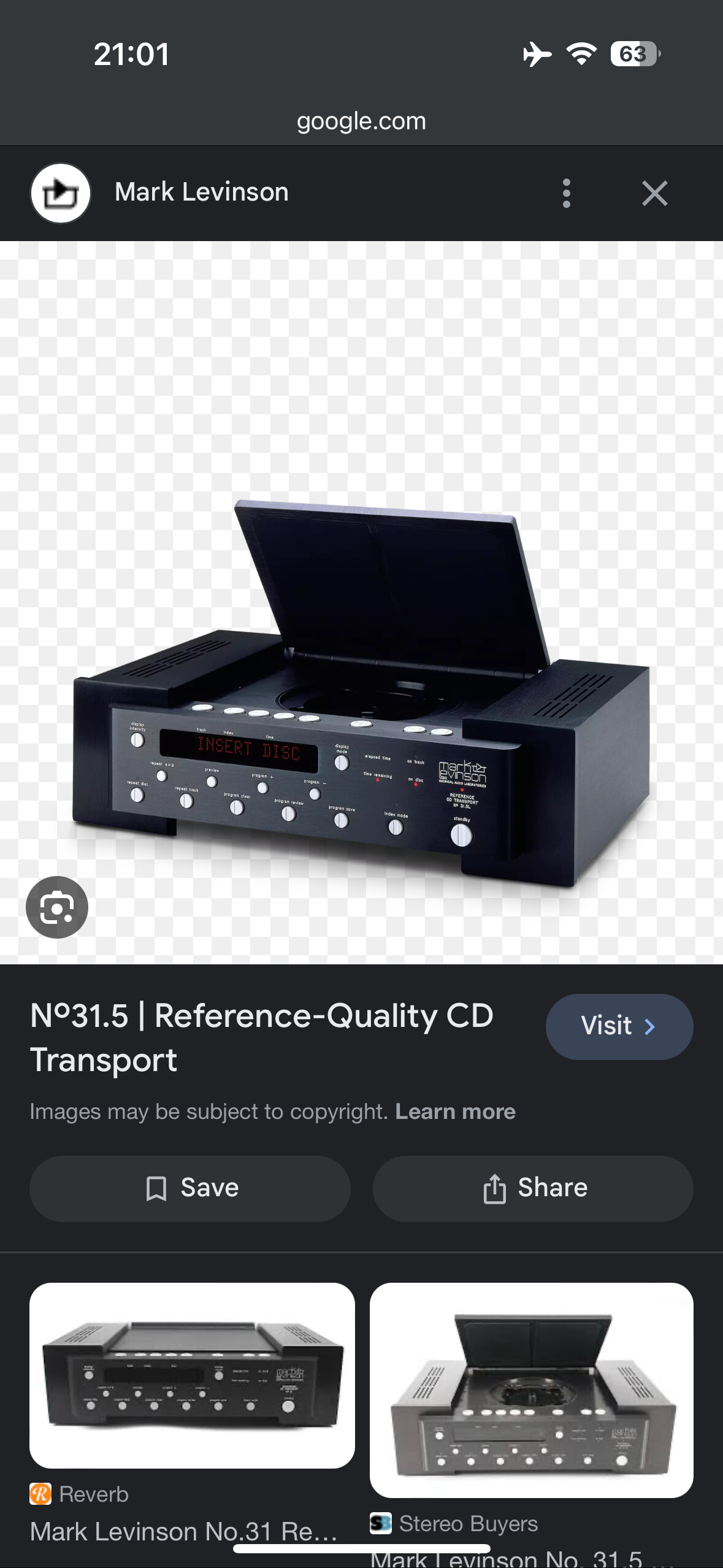

I had one of these several years ago, it was great, but I sold it as I moved to ripped CDs and only stream now
