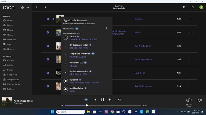

I’m also new in DSD.
What I don’t understand in the signal pad you show is why there is first a bit depth conversion from 24 bit to 64 bit and two steps further again ( but then from 64 to 32 bits).
I also see this happening in my signal pads.
What’s the reason for this?
Many thanks.

Because Roon converts to 64 bit before every DSP in order to minimize the effects of the small but inevitable mathematical errors when performing DSP calculations. This way, they get pushed into the least significant bits of the 64 data bits and become inaudible. After the DSP, it is converted down again because there is no DAC in the world that accepts 64 bit Float input. The final bitsize is usually the maximum that the DAC accepts (or as configured in the endpoint settings in Roon)
