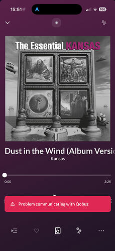

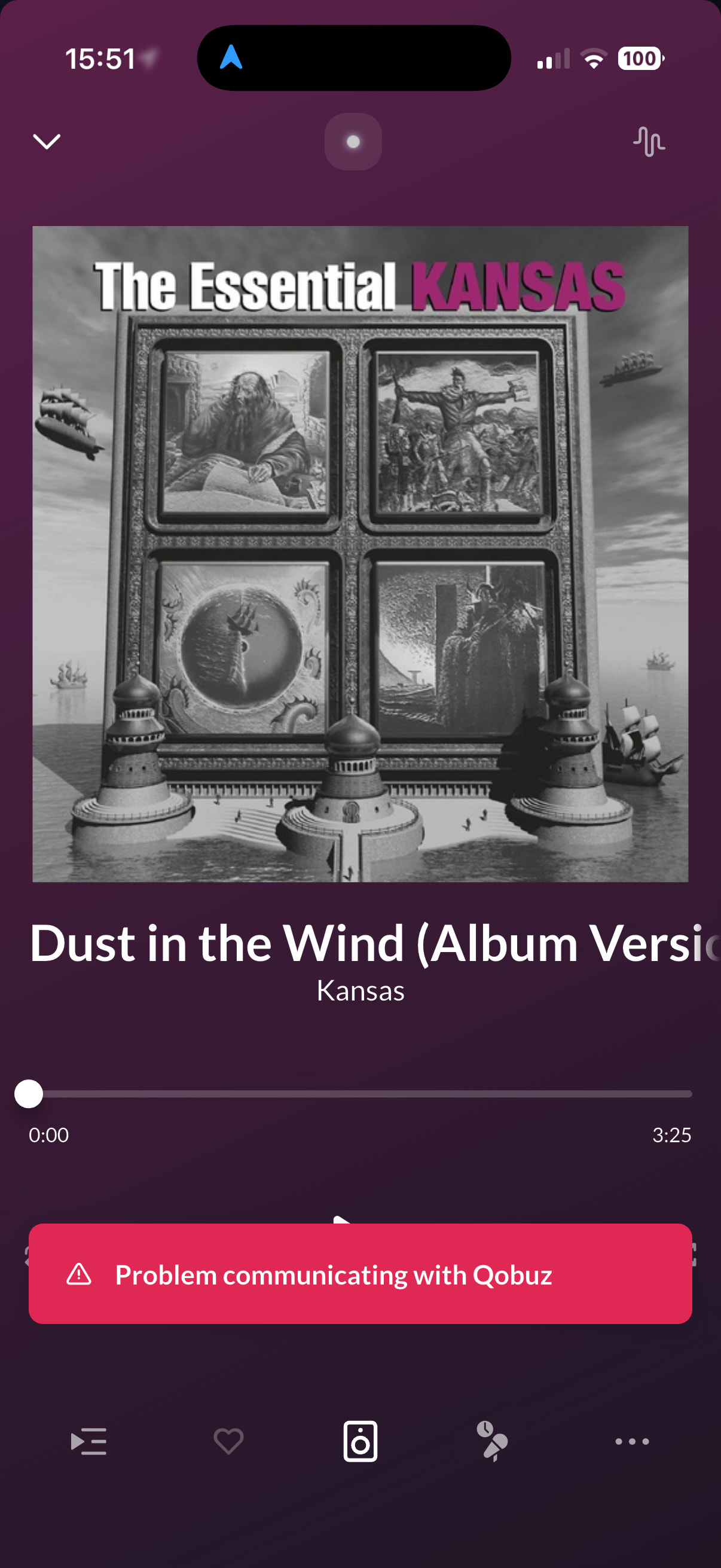

Streaming via Qobuz connect (normally not lately) Tidal Connect, and the Naim app works flawlessly. Normally Qobuz is my main streaming platform but has been particularly unreliable over the last few weeks via Roon, ARC, and Qobuz Connect due to well-known issues.

The ARC problem is currently a known issue that has something to do with Qobuz and affects several (many?) users. Though the precise cause is as of now unknown. This is being tracked here:

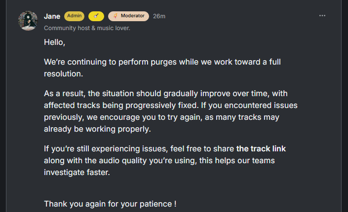

There was also another, possibly related Qobuz issue caused by Qobuz reorganizing servers. This affected not just Roon (the regular Roon, not ARC). It is partially improved but not fixed for everyone and is being tracked here:
Qobuz published this update:

Perhaps you’ve both missed this post. Looks like the recent changes that Qobuz made to its CDN have caused the Roon problems…

I’ve been on and off Early Release when major issues arise, and have it now on my Nucleus One, and it is currently resolving all of the Qobuz issues that were present over the last 2-3 months.
