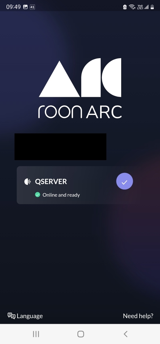

But just to clarify, this is what I see:
Just to try something, I logged in again to Roon from ARC:
this is what I got:
But it never actually fully connects
When I close and re-open ARC, I get the endless “searching” again.
I also tried restarting my router and restarting my Roon Core PC.
Same result.
