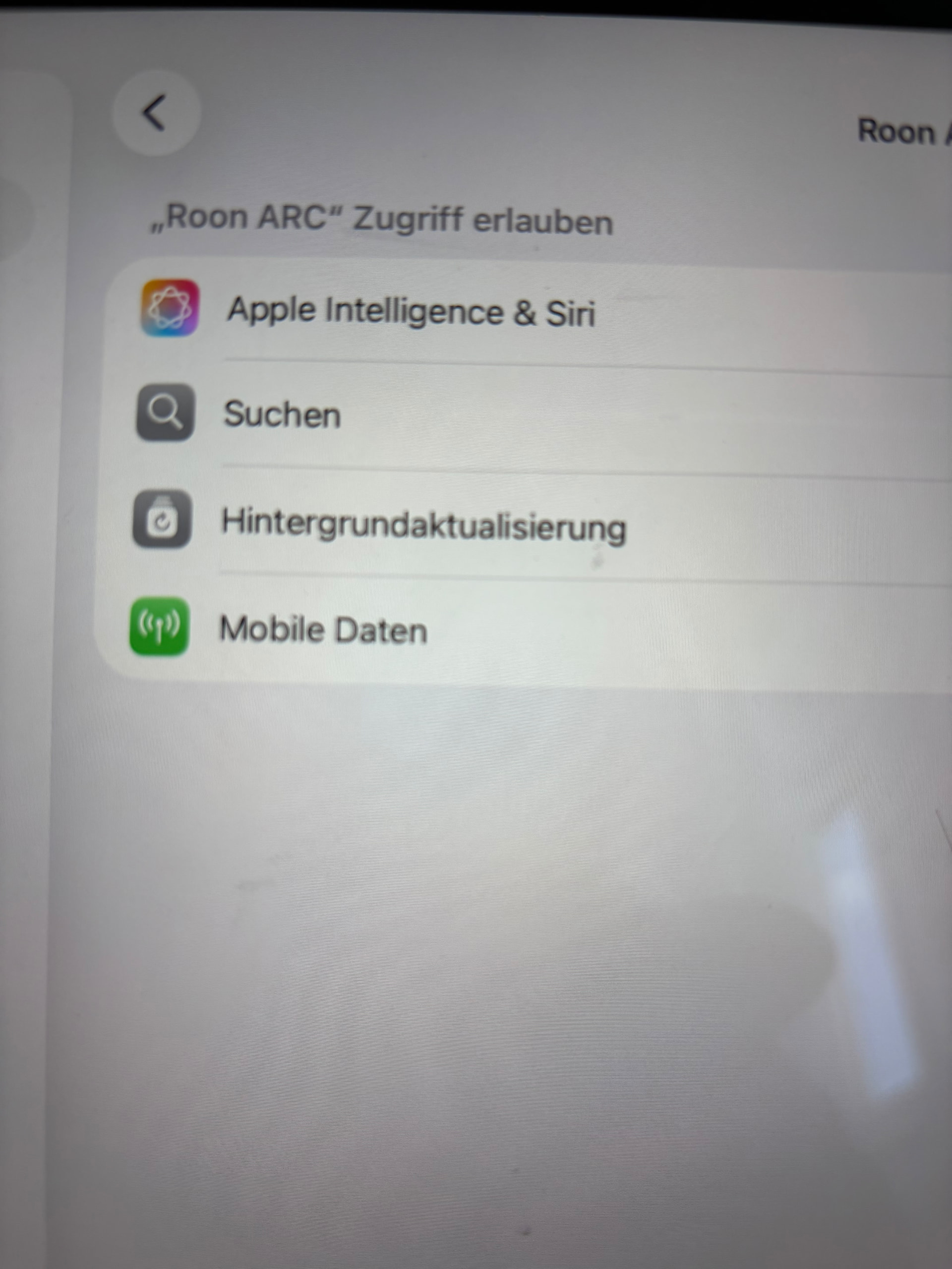

Interesting. iPad does not show options

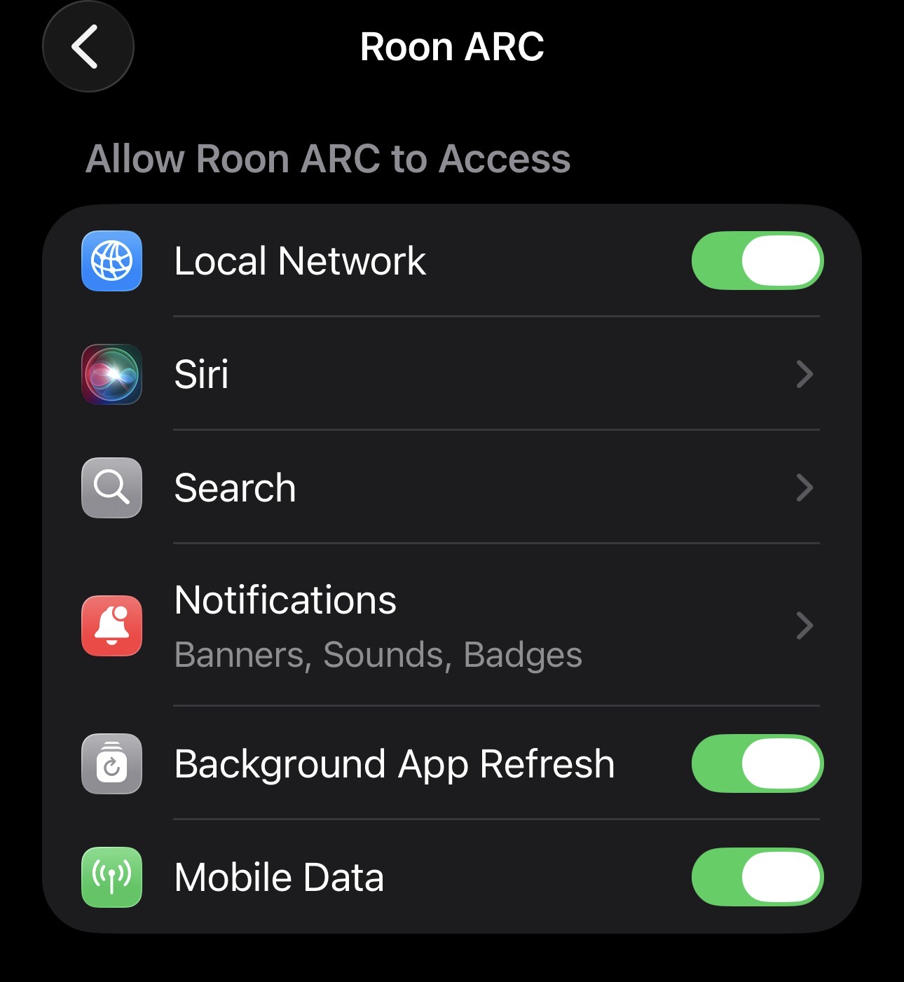

Background refresh and local network access. iPhone does and both run on 26.5.

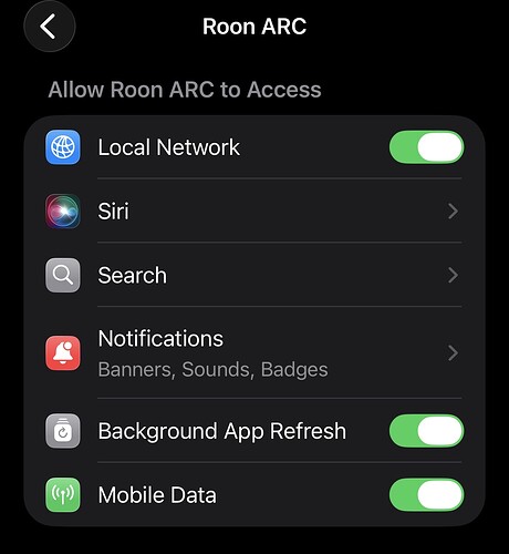

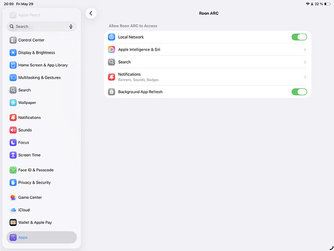

Strange. It does on my iPad, also 26.5:
I note that yours shows no Notifications option either. Mine doesn’t have the Mobile Data option because it’s a wifi-only model.

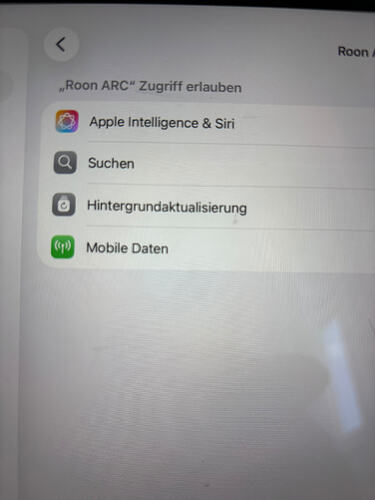

Roon ARC appears to be the only app that does not show local network access etc. Roon does.
I reinstalled ARC, same deal. Will check when back home on my other iPads.

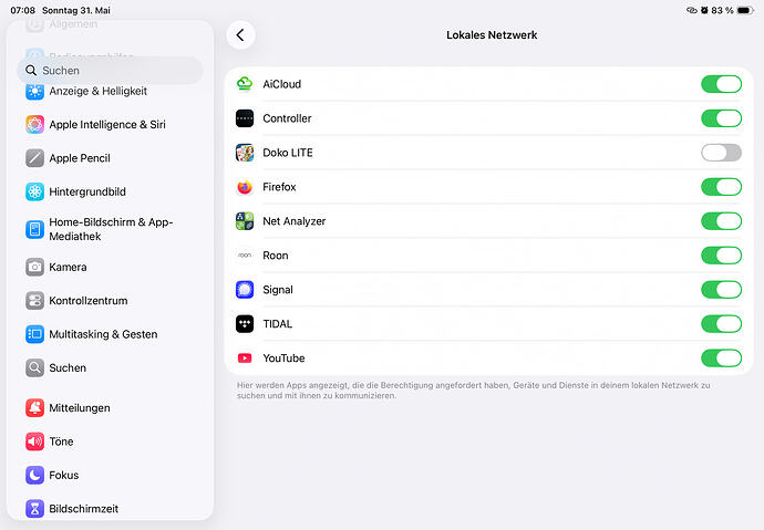

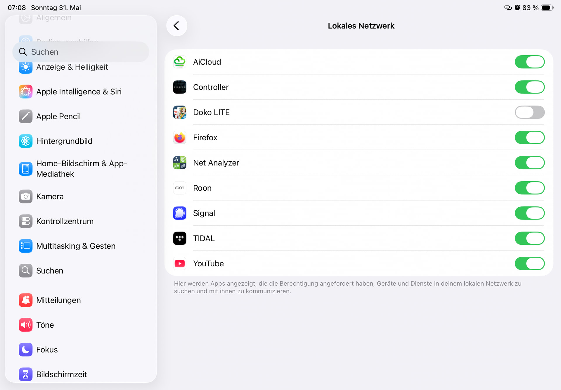

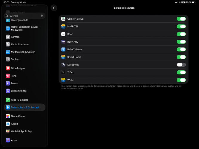

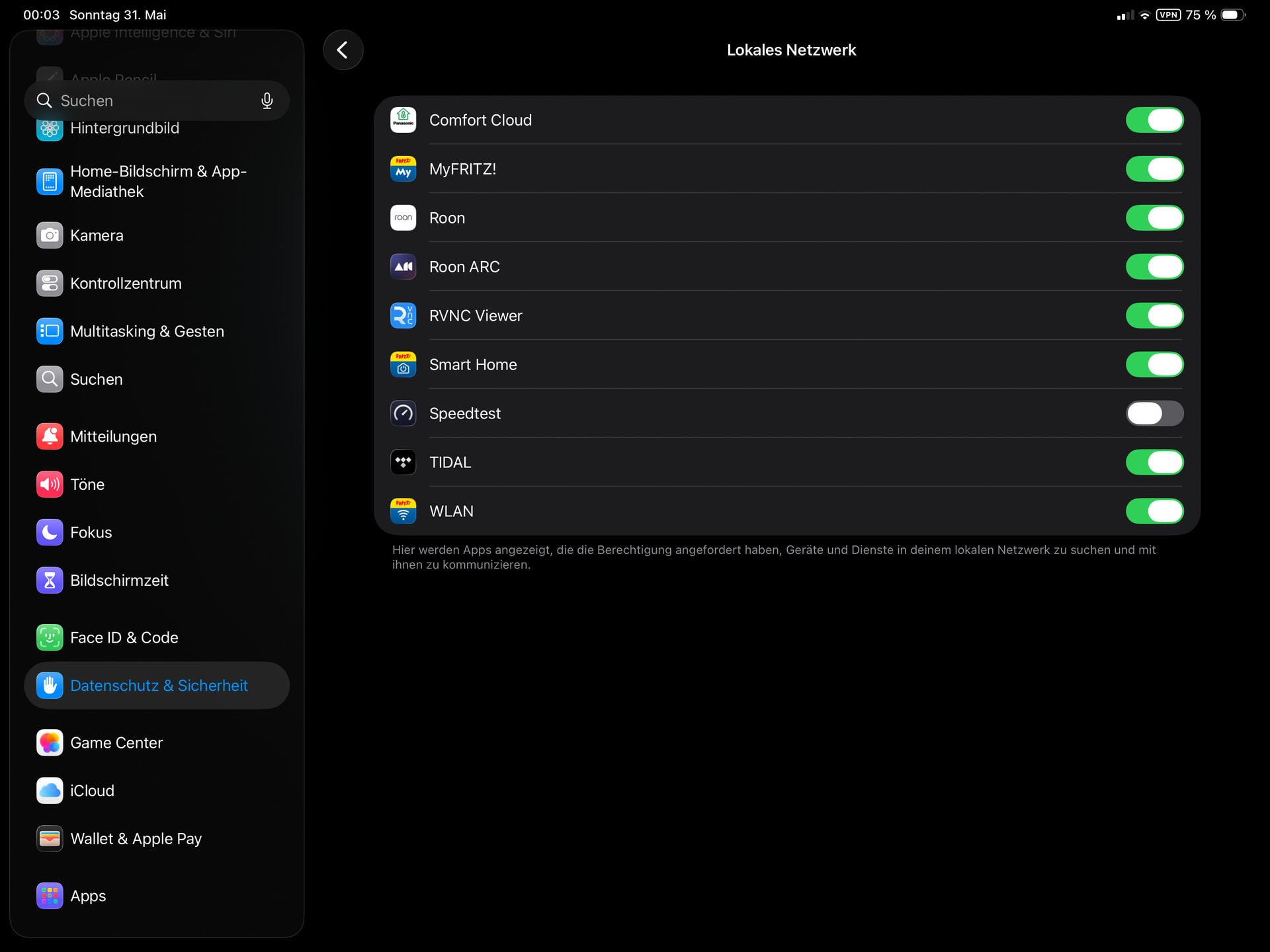

I use it on my iPad Pro M2 WiFi only and on my iPad Pro M5 with cellular without any Problem. Do you use any kind of VPN on yours?
Check this in your iPad settings:
Roon ARC doesn’t show up in the list. Something is amiss here. Is it possible that ARC must be installed while in your home network? I installed it when I went on a longer Trip.
Try uninstalling ARC completely and reinstall via Apple AppStore. I remember that there is something popping up like „Roon möchte auf andere GerĂ€te in deinem Netzwerk zugreifen" and you have to allow it

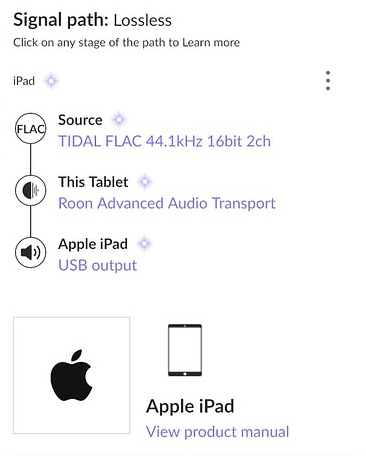

That’s a bummer. I installed both ARC and the roon app on my iPad Pro, only to discover that the actual roon app won’t output to my DAC connected to the iPad. And aside from it appearing using all the screen’s real estate. It did output sound on the laptop where the roon server lives, aka Mission Control. It’s kind of a joke that roon can’t blow up the size of ARC to utilize the iPad’s screen space. But it works, so there’s that. Deleting the main roon app off my iDevices, since it’s pointless.
The main Roon app is both a remote control for the server and an endpoint. It’s not pointless if one wants to control Roon with it (and it can do much more than the ARC app). When using the iPad as an endpoint, you can choose the iPad as the output, and it definitely can output to the USB port. E.g., look that this signal path from another thread:

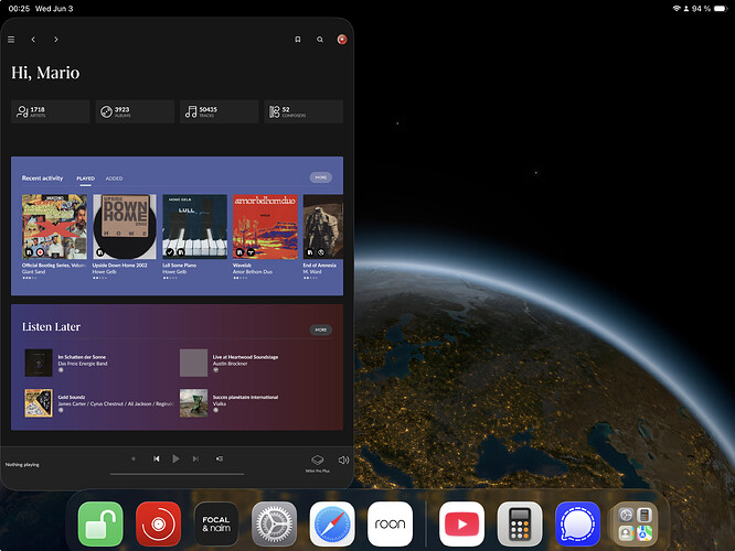

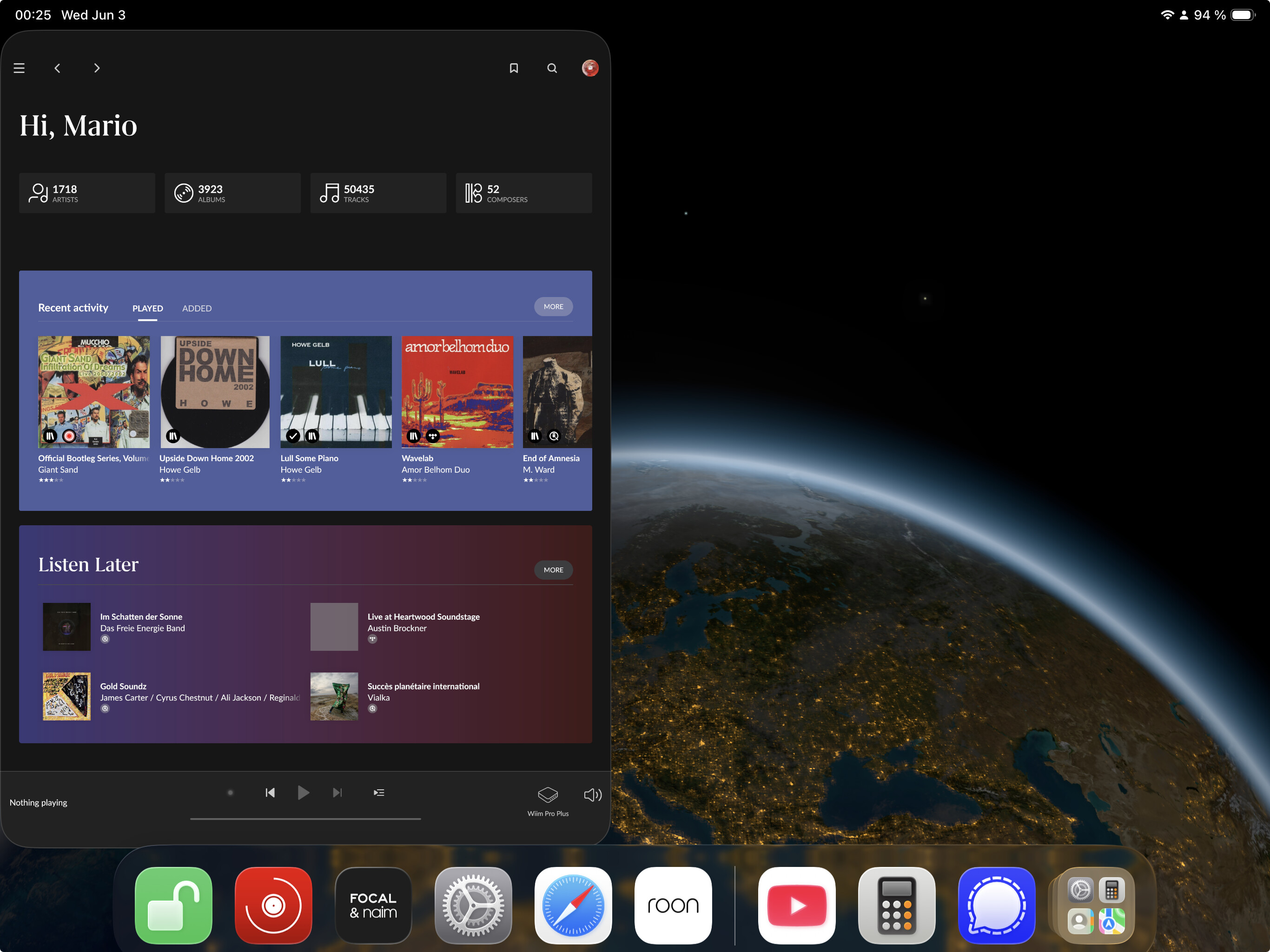

For what it’s worth, you can definitely run the main app in windowed mode if you have a modern version of iPadOS that supports windowed mode, and if your iPad is large enough. This is on a 12.9" iPad:
