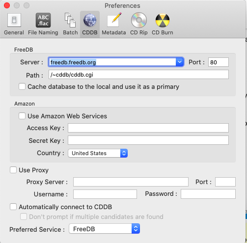

I have been experimenting with XLD having followed the settings suggested in this video - less than a year old, which relies on freedb with the server as ‘freedb.freedb.org’ and the path as ‘/cddb/cddb.cgi’ - as at around 3’21".
CD always not found.

Hi Mark,
I’ve attached a screenshot of my XLD settings page for fetching metadata. Yes, I occasionally get a “CD not found” with my more obscure classical CDs, but not very often. Do you have a big-selling Pop/Rock CD you could test with? This would at least prove whether you are connecting to the FreeDB database or not.
Just noticed in my settings there is a “~” in the Path that you don’t have. Not sure if this is relevant.
