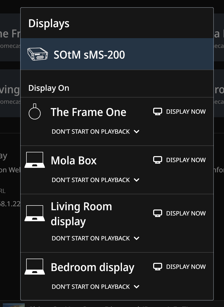

After sometimes, the display selection are populated with the same chromecast entries.

I keep my Rock on and connected all the time. So after sometimes, from any Roon client you will see the duplication from the little display icon under speaker icon on the bottom right, when I want activate display or from setting menu. Over the time, new duplicate entries were added.
If I restart Rock, this problem gone.
