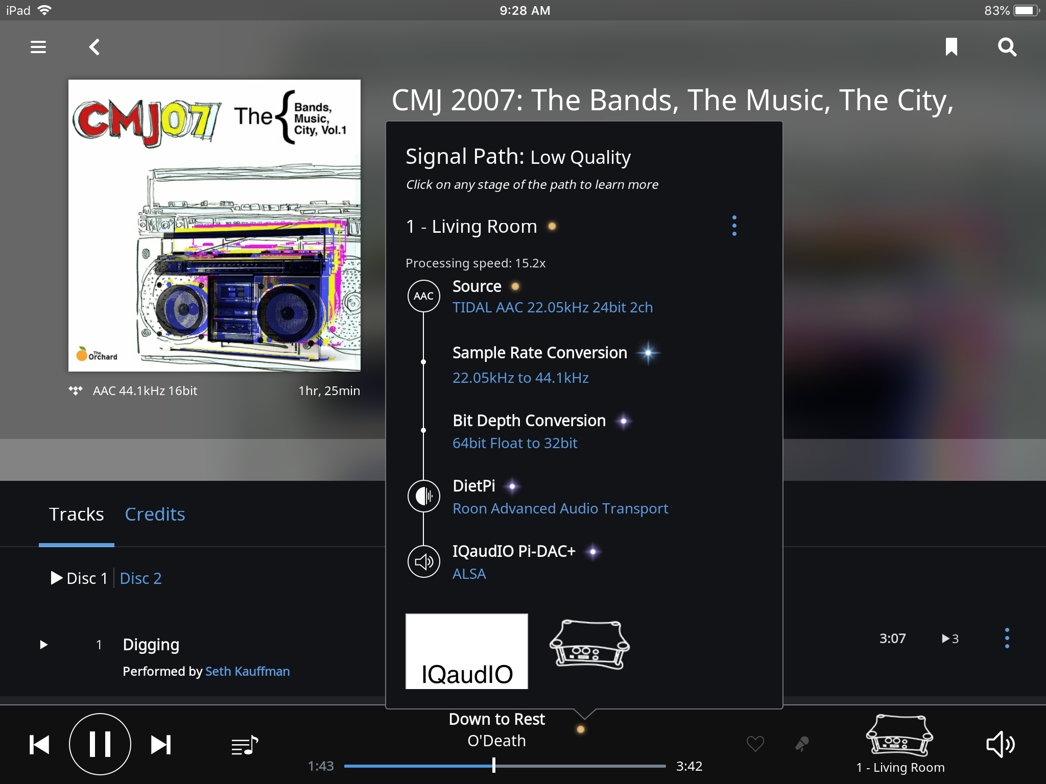

Hi Eric,
I’m hearing the same crackling distortion on track #2 (Down to Rest) at about 1:30 mark, in Mark’s example above.
Using my ROCK NUC thought IQaudIO DAC to my speakers.
I also had Headroom management on (only) with -3 adjustment to avoid the clipping indicator.
Cheers, Greg
