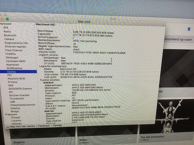

. The Mac-mini just has a HDD - disk. I will send you a printscreen of the system of the mac-mini.

Hello @Jeroen_Kooi,
Thanks for providing the requested troubleshooting steps and the screenshot. I couldn’t help but notice that you are running very low on available space on your Hard Disk. 2.08/2.11TB used. Is this hard drive the location where your Roon Database is also stored?
That could be an explanation of why you are running into this issue, I would recommend making some space available for Roon to operate properly by moving any unneeded files on that disk over to another hard disk. I would recommend you have at least 500MB free on the hard disk that contains the database as that would be my first step here.
An additional test that we can run here is by trying to add the album to your favorites using the TIDAL app and seeing if it shows up in Roon after a force refresh. To do those steps, open the TIDAL app, add the Joan Armatrading album to your TIDAL library from inside the app, open Roon and force a TIDAL refresh and see if it shows up in Roon.
I highly recommend that you try clearing some space on your hard disk first before running the second test as this seems to indicate a performance issue where the database is unable to add more content because it is out of space. Please let me know your findings after doing so.
