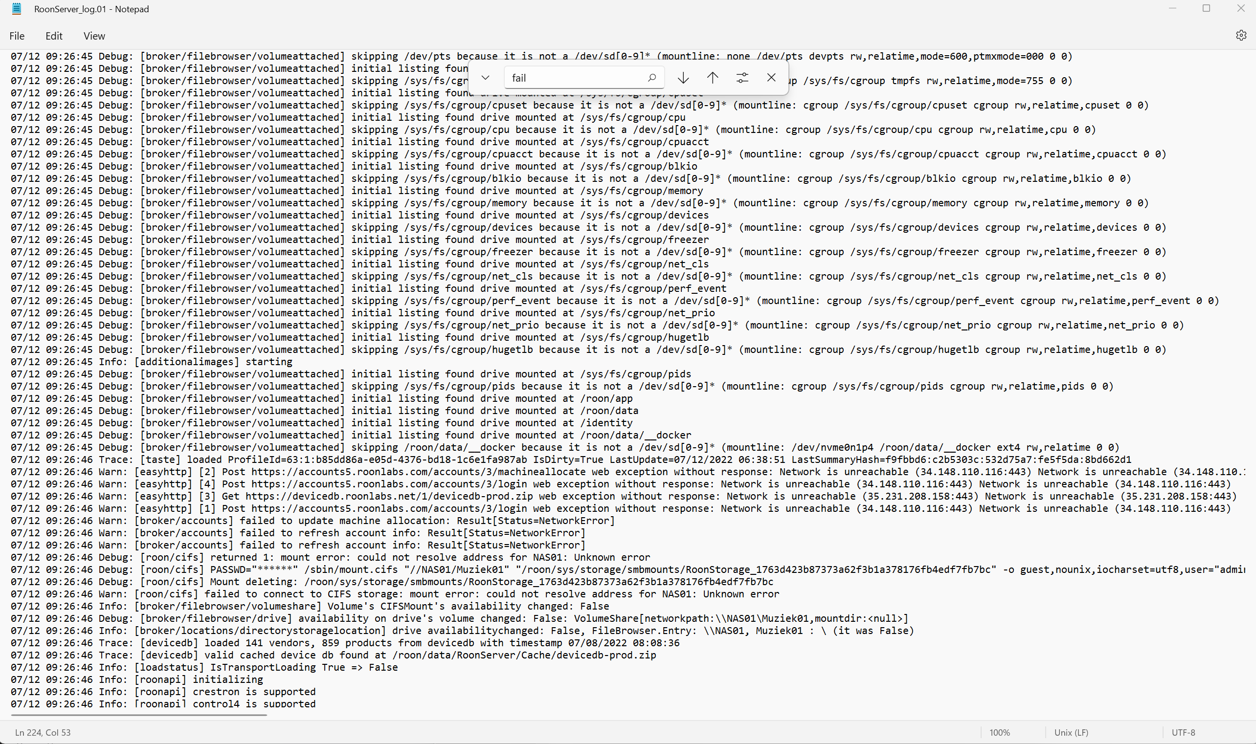

From the messages in the browser and from the roonserver log it appears to be something with “oauthcb.roonlabs.net” as it times out. So the feedback into /oon of the successfull login into Tidal fails.
(apparently i cannot upload the logfile, so i made a screencopy of a part)
My knowledge of unix is very rusty, so this is as far as i can get on this. So please help .
Going deeper into the logfile i found this:
looking in the raatserver log i find this:
