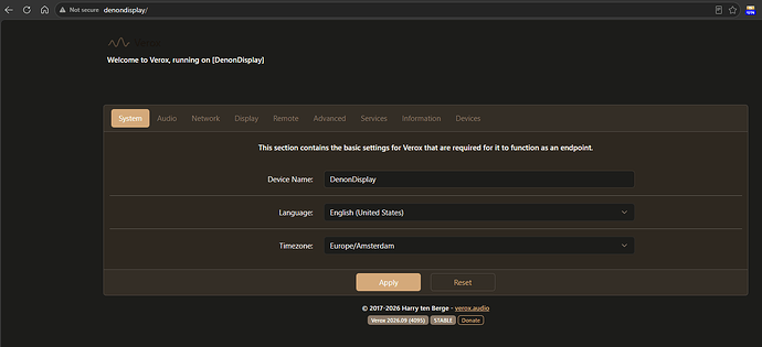

What happens if you try http://verox.local or just http://verox ? There’s been a name change…
Note: if you’ve named the device in RoPieee, then you should use that name instead, e.g.:slight_smile:
I cannot get to it with http://verox.local or the IP address. The screenshot you posted, is that from the web interface or a monitor hooked to your Raspberry Pi?
