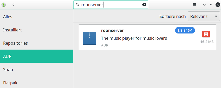

The distribution Manjaro https://manjaro.org/ makes it even easier, because there you can get this in the Linux store.
Klick and ready
