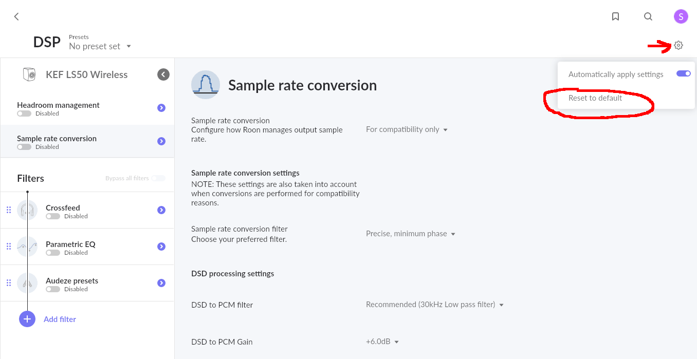

It looks like you are using Sample Rate Conversion in Roon.
Maybe DAC 1000 is incompatible with 384 kHz.
Try to reset Roon DSP to default settings
