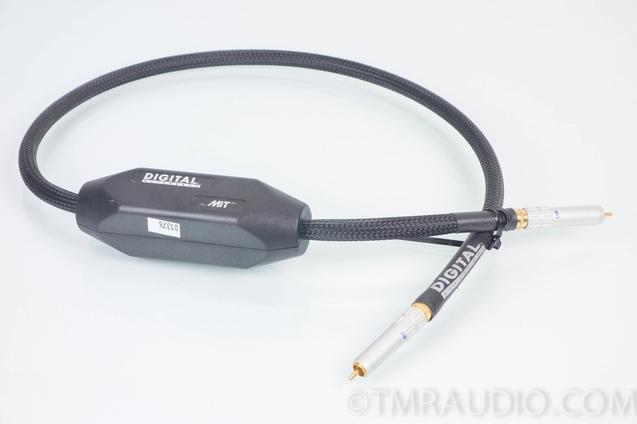

Do you have any specs for the MIT Cable , it looks like a speaker cable but I can’t find details. I may be limited to 96 , that would explain a lot ?? Do you have another coax cable , even a RCA cable may be OK to test
is this it ?

First of all the picture of the cable you have sent is the right one.
I have taken the mie to test the same track with Qobuz app on my Mac with Airplay in two HiRes, and the 192kHz/24b is better than the 96kHz/24 version. If everything is downsample to 44kHz/16b because I use Airplay how do you explain that I can hear a difference ?
Not sure I know what the blob in the middle of the cable is doing ? I suspect this is quite old and probably pre Hi Res files ?

Then it must be the cable it looks like the only variable at this stage

Do you have another coax cable or maybe a spare RCA to RCA cable ? Swap out the MIT one as a test (a coax is a posh RCA to RCA cable) it may work just to test
the other way is plug the RCA analogue cables on your preamp into the analogue outs of the CXN and NOT your DAC , that will eliminate the MIT Cable
Regarding the MIT Digital reference it has been created in 1996.
No one had Hi Res in 1996 !!, Try the CXN analogue out to preamp test that should prove it

so I have shift the MIT Digital Reference coax cable and put a Kimber KCTG Digital cable and the problem is the same. No sound.
