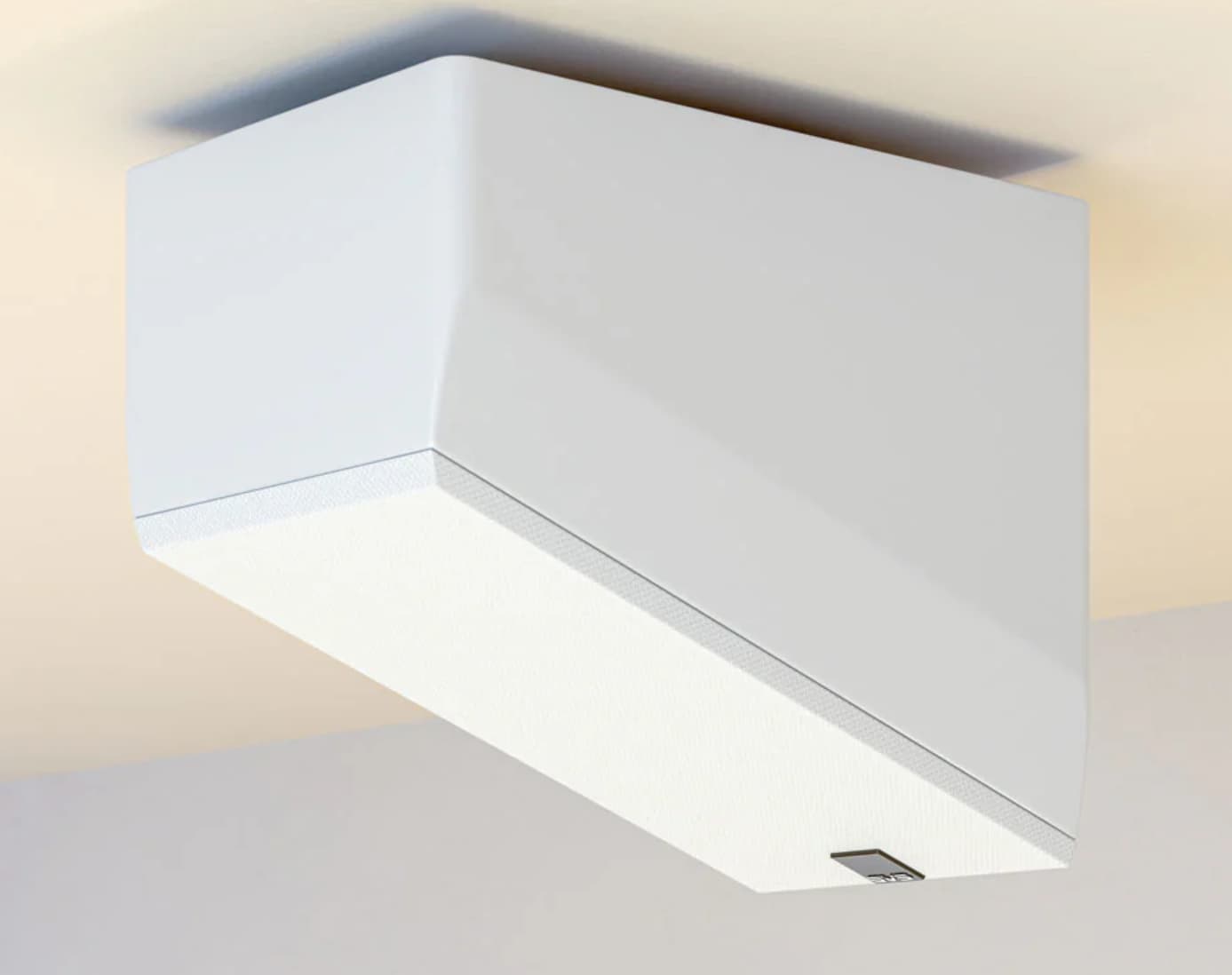

I use SVS Prime Elevation for ceiling speakers in our living room. The ceiling is vaulted with no space above for in-ceiling speakers so we used the Elevations.
The supplied mounting brackets are good for any location and the speakers are uniquely shaped (angled) for positioning on high walls or ceiling.
The Prime Elevations are $249 each. SVS has a newer higher end model Ultra Evolution Elevations for $449 each.
