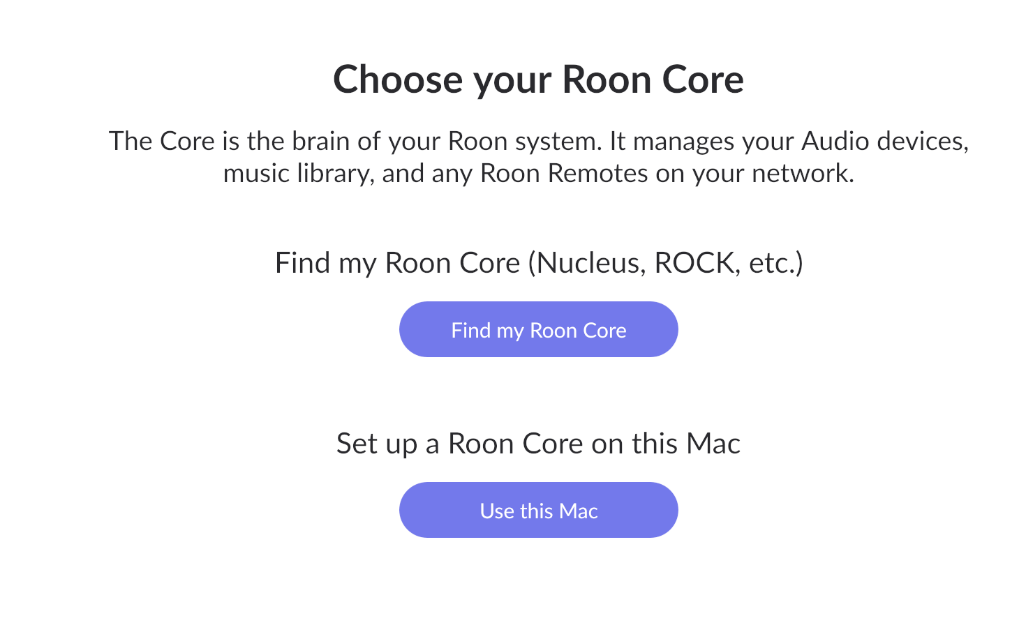

I continue to try to solve the problem that I described here. Through the process of elimination (swapping the router, reducing and now perhaps eliminating the switches), I hope to resolve the issue.
I am attempting to eliminate the switch from my network configuration after Synology advised that I can connect my router directly to my NAS at one ethernet port and Roon ROCK at the other. When doing so, I no longer see Roon ROCK.
What do I need to do in order to launch Roon?
Here are some screenshots that better describe the situation:
David

Okay, thanks for clearing that up. I reconnected the switch and was able to reset the NAS and can now access it (I wasn’t able to do so earlier). I am still unable to access Roon. When launching Roon, it is seeking out the static IP address I plugged in earlier and never latches:
I then tap on “Configure Roon OS…” and get this reply:
After letting it spin, I tap on the 192.168.86.40 link and
as that is not the correct IP after the reset. Do I need to do a reinstall as described [here] (please say no…)?
