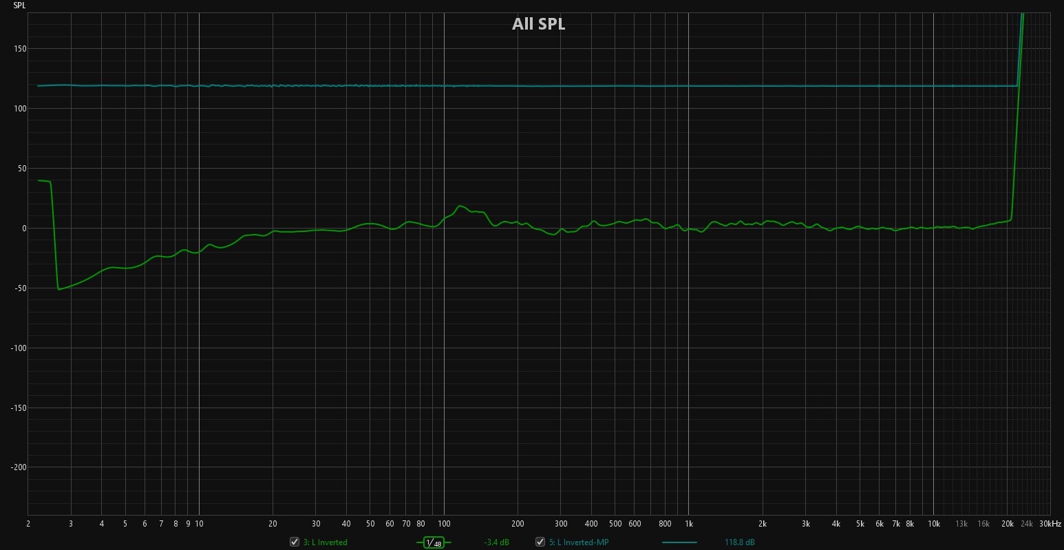

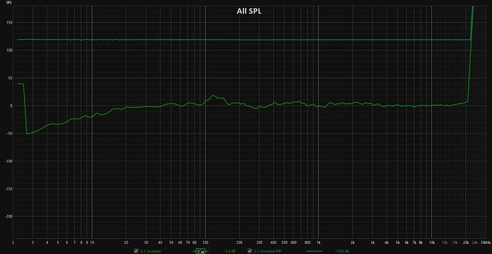

I’ve been following the video (and the associated pdf) and am getting weird results when generating the minimum phase versions. The -MP versions are showing up as very straight lines at extreme SPL levels and look nothing like the expected results. Note: I am using REW V5.31.3 currently.
Any ideas?
