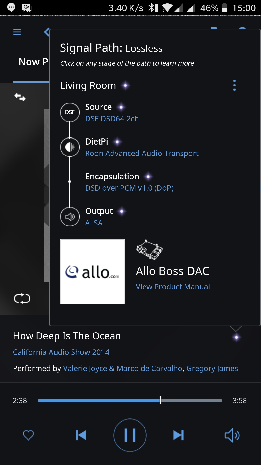

New Roon user here. Setup ROCK yesterday and set Allo Boss on DietPi to DSD over PCM under Playback. When I play a DSD64 file, I only hear static.
As soon as I change Playback setting to Convert to PCM, it sounds fine.
ROCK is at 1.4 (build 294)
Roon Bridge [DietPi] is at version 1.0 (build 135); DietPi is at version 159
Am I missing something?

@Allan_Hsu I played around with Volume Control Mode in Device Setup for the BossDAC:
Use Device Controls (volume at 100) = static (problem persists)
Fixed Volume = static (problem persists)
DSP Volume = plays song but converts to PCM
Any other suggestions? Thank you for your time.

AFAIK, the Boss is a PCM5122 DAC that does not support DSD. Roon probably allows sending out DSD64 over DoP since the enhanced 384kHz driver offers the bandwidth required and there’s no way for Roon to see whether it supports DSD or not.
@RBM That makes sense; thanks for explaining.
Confirmed here also:
