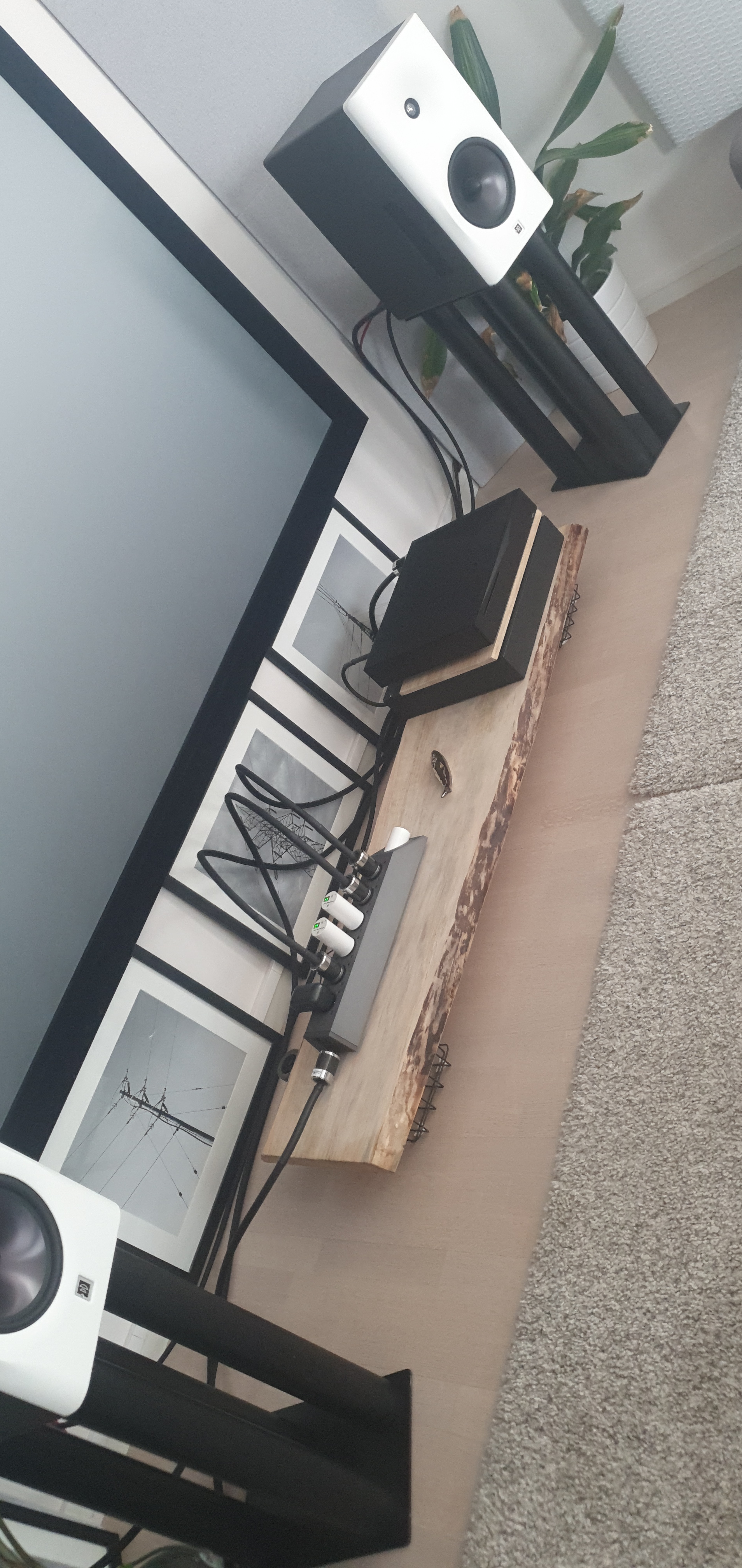

@J.D the Genelecâs have gone?
New colour 8Câs in?
Yes, I use Ropieee running on a pi4 with a Hifiberry hat as Roon endpoint and this combo is a very good solution.
Hello,
Nope Genelec 8361A still standing in my livingroom
