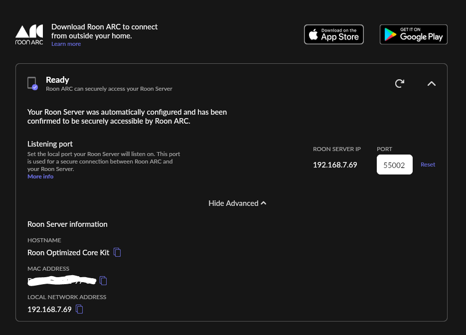

Might also do a screenshot of the expanded window:

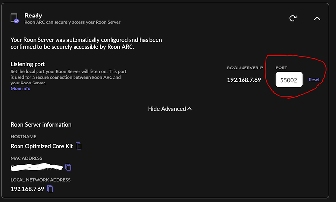

In Roon go to Settings/Roon ARC and hit the arrow to expand the box:

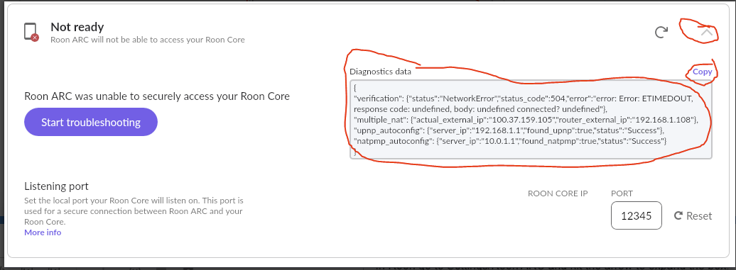

Then if you see the diagnostics data like this:
Hit “copy” and the “paste” (or hit CTL v) into a post so we can see the data.
Also, post a screenshot of what is in the rest of the settings/Roon ARC area of Roon.
Like what I posted earlier. Ot at least post what port it is trying to use.
