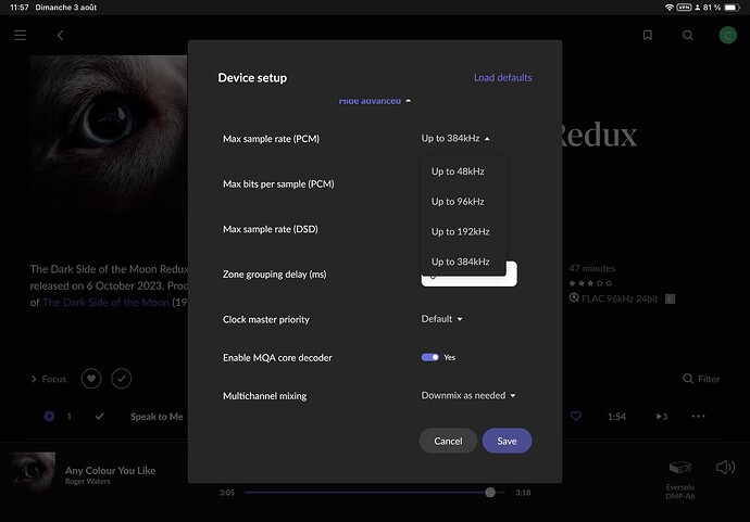

Hi,

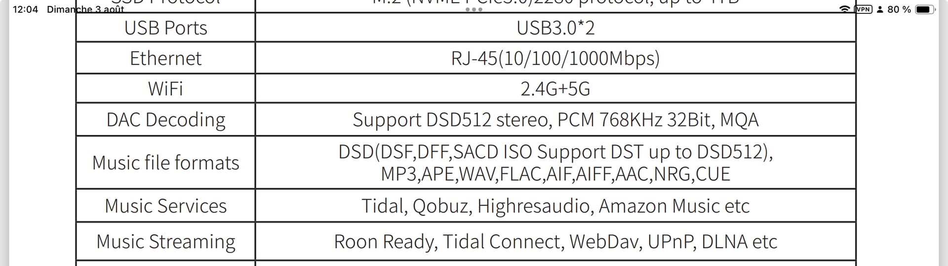

Max sample rate PCM is 768kHz but ROON recognize only 384kHz. I think it’s the value of the previous génération.
Could you actualize parameters please?

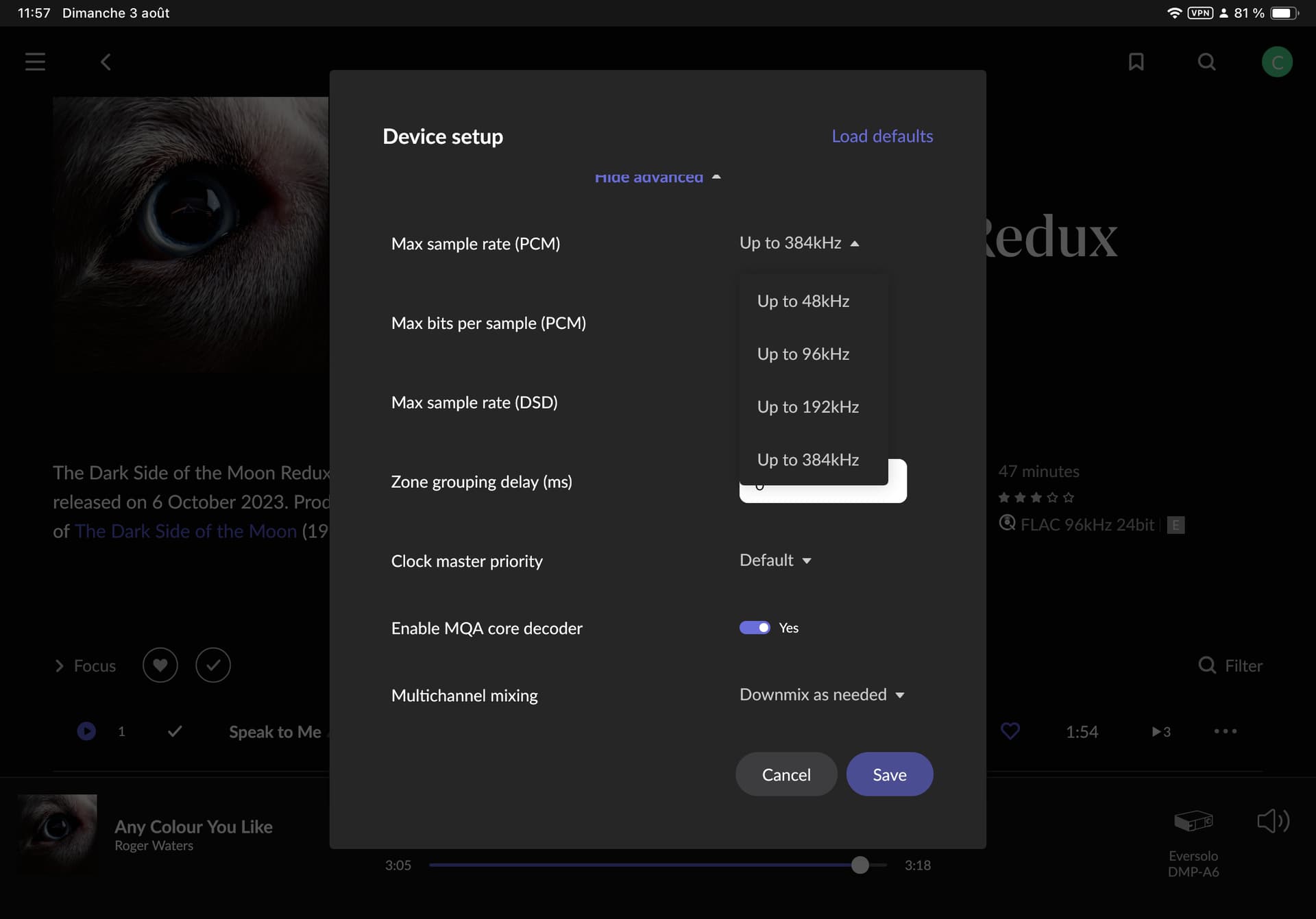

Roon supports/shows what a device itself signals (self-declares) as supported to Roon. Did you send your request to Eversolo? I think you should discuss this with the manufacturer, maybe he will release a changed firmware (or explain why you can’t get higher sample rates).

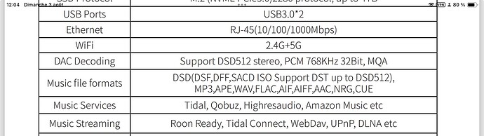

PS: From their product website the specification is given for USB and “up to”. Do you use USB and the mandatory Windows driver to achieve those maximum possible sample rates?
Sadly no specifications are given for the network input or any of the various supported network protocols respectively.
Indeed, roon ready devices always have their specific limits when it comes to specific inputs like e.g. USB, digital Coax, optical, HDMI as well as roon/RAAT. In most cases device manufacturers do not show them for RAAT.

Your Eversolo is connected to the roon server via USB or Ethernet?
My Eversolo is connected to the roon server via Ethernet
Then, I believe, the answer is pretty clear. The Eversolo’s RAAT input only supports up to 384kHz whereas its USB supports up to 768kHz as noted in its specs.
You may ask Eversolo if this is correct or if there might be an issue with reporting the max. PCM sampling rate to the roon server.
But I believe it’s just like it is.
You may try connecting the Eversolo via USB to your NAS but I’m not sure if this will work at all with Synology NASs.
IIRC has Synology disabled USB Audio support in DSM 7.
As I understand it, this is an oversampling DAC-Chip. 768 kHz is the frequency after the filter but as the clock is there it gets supported on the input too – but half the data just gets ignored because the filter input is 384 kHz max that then gets oversampled and filtered (to 768 kHz before further processing). 768 kHz is also listed as max USB output frequency. I assume they use a Linux of some sorts as OS – so specific DAC drivers may be harder to come by as with Windows. While there might be a slight chance for a given DAC to be supported, most probably won’t. Currently most DAC’s supporting 768 kHz are in the same boat regarding supported sampling frequency as the DMP-A6 (oversampling DAC-Chips that allow for 384 kHz max as filter input). So it seems to me that there is currently hardly a need to provide 768 kHz support. But again, you need to discuss this with Eversolo – Roon can do higher sampling rates when signaled as supported by endpoints. If the Gen 2 differs from the OG device then its firmware must reflect that and the device may even have to undergo the certification process again.

The Eversolo’s answer : A6 ME ROON PCM supports up to 384KHz, which is the limitation of ROON.

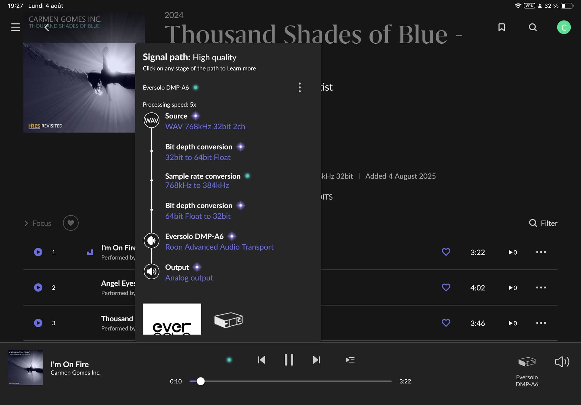

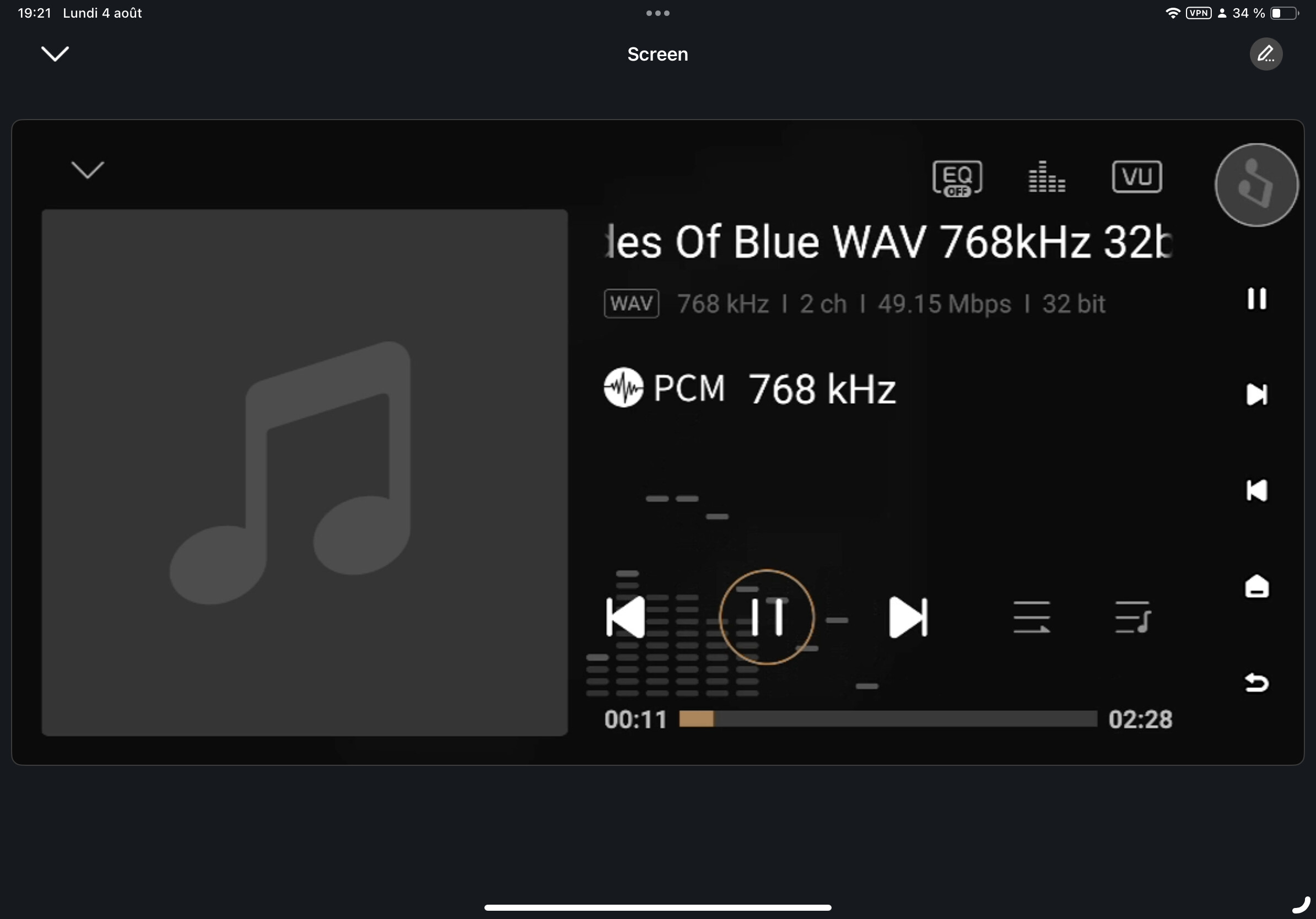

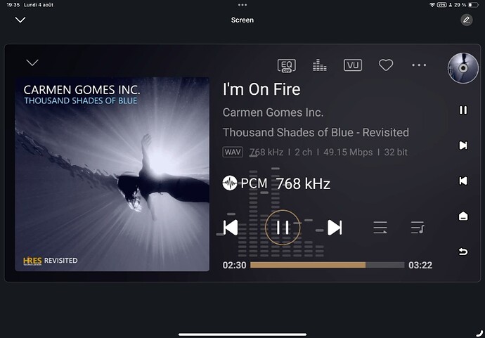

Eversolo DMP A6 GEN 2 MASTER EDITION play PMC 768kHz with ethernet to RCA connection.without ROON.
Roon downsampling the same file in 384kHz.
Is it a ROON’s limitation or an issue by EVERSOLO?
It is a limitation in conjunction with your device. It is Eversolo who is responsible for the Roon Ready support they implemented into their device. You should discuss your device related issue with Eversolo support.

And again and to my knowledge, your device is a PCM 384 kHz device that just happens to allow you to send 768 kHz also (for convenience and if you do it might delete half of the data it just received). For external USB DACs you may connect, it likely has no individual driver anyway that would support 768 kHz playback. If that external DAC is also based on an off-the-shelf common DAC-Chip listed with a max 768 kHz input capability it means that he most likely suffers from the same limitation. A NOS DAC that support that or even higher frequencies are currently likely the only ones capable of using 768 kHz tracks.
This conversation interests me but I don’t understand why you say that the Eversolo player cannot decode the 768kHz PCM when its DAC consists of 2 ES9038Q2M chips. One per channel. Each of the 2 chips decodes the 768kHz PCM natively according to the manufacturer’s data sheet that can be consulted at https://www.esstech.com/wp-content/uploads/2022/09/ES9038Q2M-Datasheet-v1.4.pd
Could you explain?
As I wrote in the other thread already, see page 21.
They use an 8 times FIR filter. 8 times filters are what currently seems to be standard for integrated DAC-Chips throughout the board of manufacturers.
8 x 48 kHz = 384 kHz
