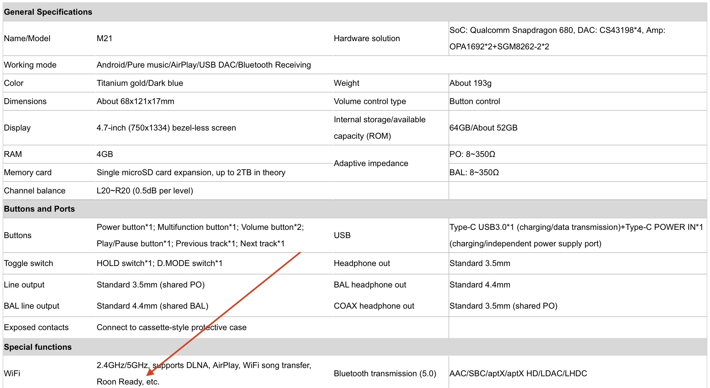

Good morning, could someone who has owned the Fiio M21 confirm if it is Roon Ready?
Because the information is all confusing.
Some places say yes, the manual says yes, but the information on the product’s main page at Fiio says nothing.

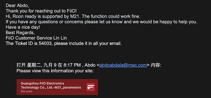

I wrote to Fiio, but the response is also super confusing… Could someone clarify?

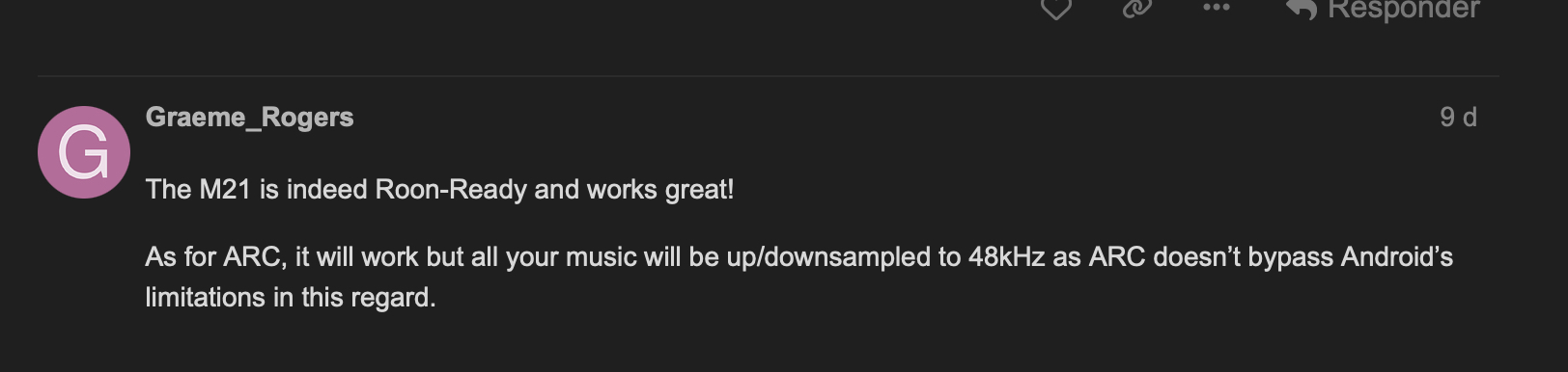

I also found a user on Roon who said the M21 is Roon Ready… go figure. By the way, the Roon partners page with Fiio seems very outdated, as there are items on the Fiio page that mention the M23 being Roon Ready and on Roon nothing… everything is strange.

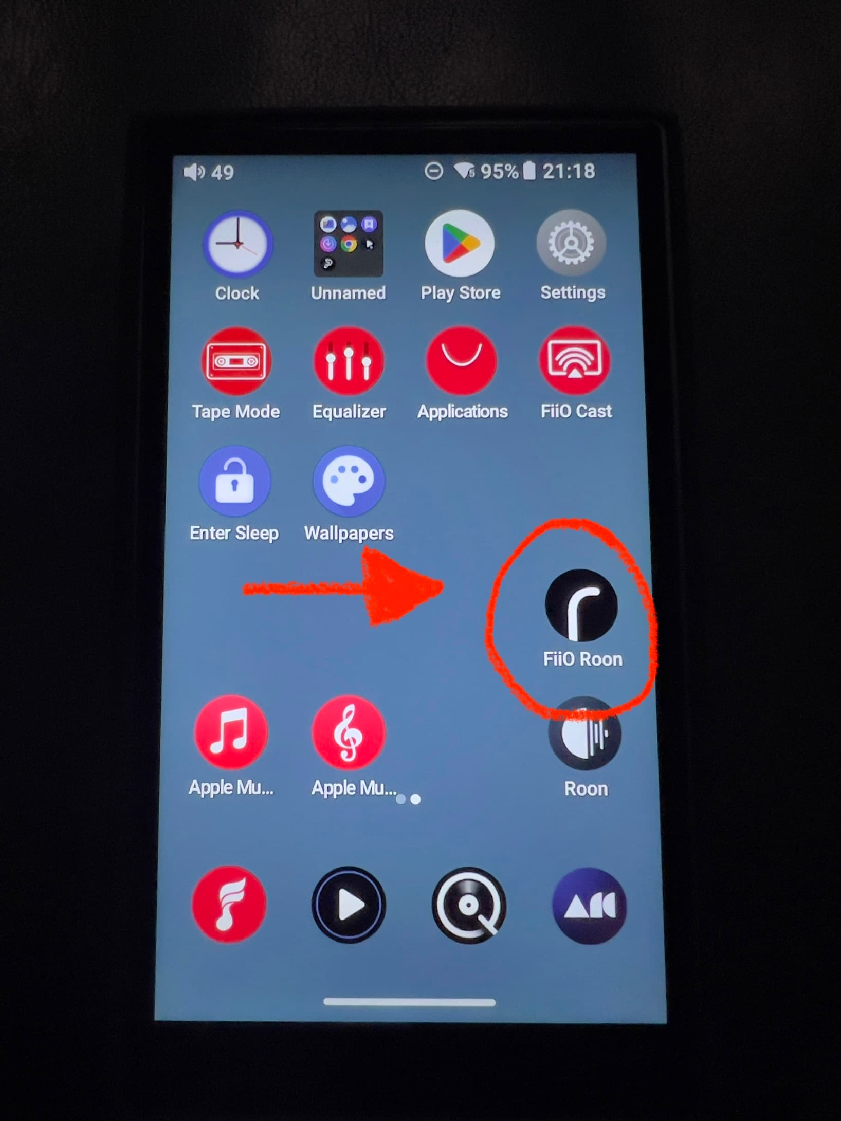

Just received my FiiO M21 and it says it is room ready it’s coming with an app called “FiiO Roon”
To be honest I do not know how to use it yet. But it’s there.
Yes, the app is there, but it doesn’t work yet because it’s not authenticated for Roon Ready. But what you can do is go to the Google Play app store and download the Roon app, and you’ll at least be able to access your Roon account.

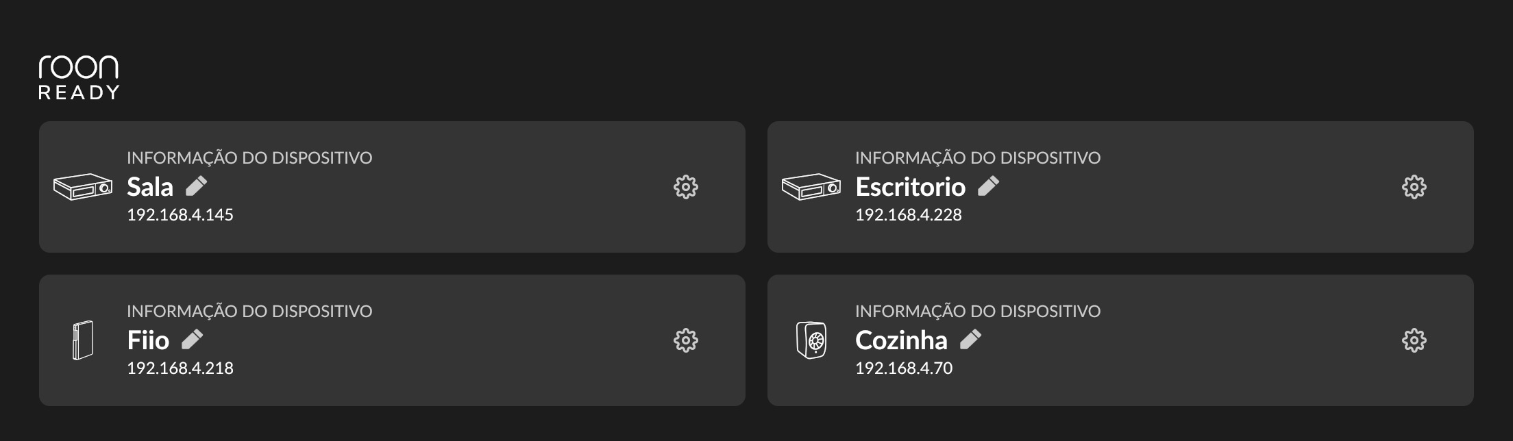

Roon Ready Certified M21 !!! Great

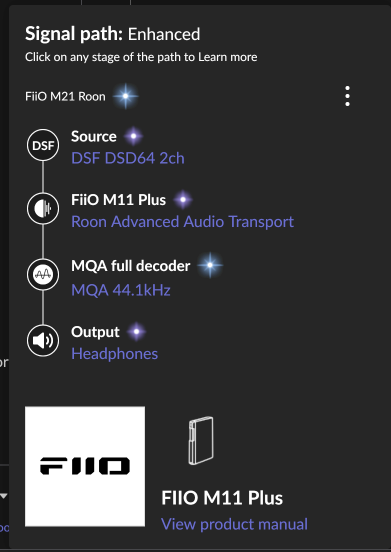

So you don’t understand how Roon works on DAPs like from Fiio or A&K!
So: Start the Fiio Roon App and you will see in Roon Remote under audio your M21.
Activate it and then you can play from Roon Remote something to the M21 without resampling.
Everytime you start your DAP, you’ve to activate on it Roon through starting the app.
I had no idea because it doesn’t say anywhere how to do it. Thanks for the instructions, that helped. For some reason it’s showing M11 Plus instead of M21 but I guess the hardware structure is the same. Also, weird thing is happening, I’m playing a DSD file and in the path, it says it’s also MQA Enhancing it… what?
Update: it was a playback lagging issue, since my previous audio was an MQA track.

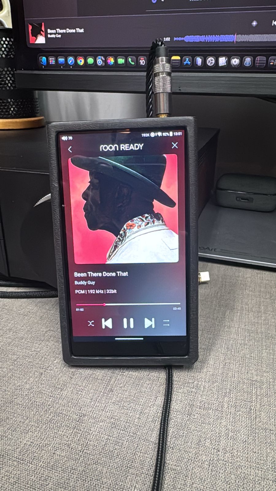

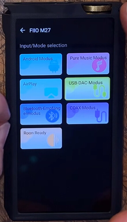

Just got my Fiio M27 and ran into the 48KHz limit issue. I followed the approach described here and it works perfectly for me - be able to play 24/96 with Roon. The only thing is that I have to open Fiio Roon app every time I use Roon and keep it open until the end. Awkward but works. Thanks.
Isn’t the M27 ROON Ready? I found a video about the M27:
My M27 is labeled as R7 under Roon Ready in the Audio setting. I am able to run Roon perfectly, as long as the Fiio Roon app is running in the background.
