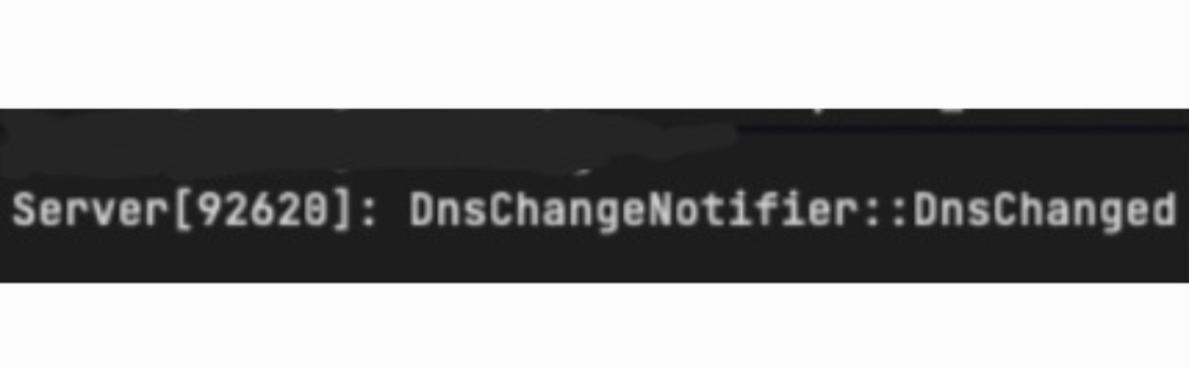

I just saw this before posting:
Can you turn off the pfsense firewall temporarily as a test?
