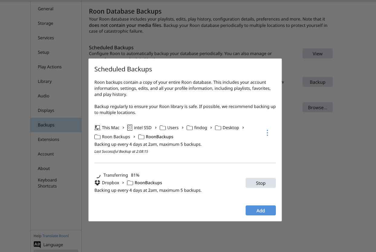

Hi @Jason_Finn,
Just to clarify here — I see that Dropbox is mounted and seen in Finder in your image above. When you are saving these backups to Dropbox are you using the Dropbox service in Roon, or are you selecting the Dropbox folder on your Mac that syncs with this? Can you share a screenshot of the Backups screen showing how this was done?
Additionally, how are you downloading these files? Are you using the Dropbox folder in Finder or are you downloading them directly from the Dropbox website?

The one backup that worked, Dylan, I saved directly to a folder named “dropbox” on my desktop. I have another backup to my dropbox sync folder, and that is not complete yet so I can’t try a backup from there.
