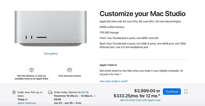

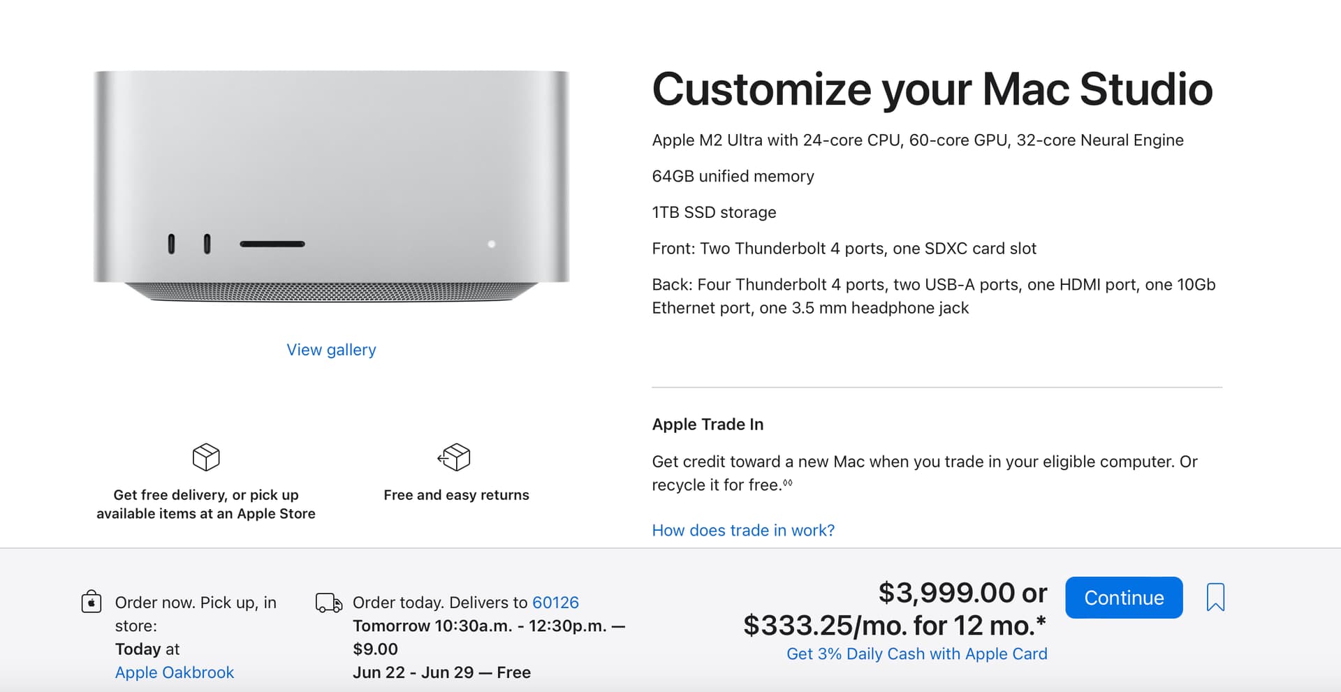

In my mind, it’s become clear that the performance deltas for HQP between M1 → M1 xxx → M2 → M2 xxx → M2 Ultra are not significant. Certainly not nearly significant enough to justify thousands of dollars on a Mac Studio. If you are happy with DSD256 and latest EC modulators you can get away with a baseline M1. If you want DSD512 then build a (mini) PC with fast Intel for not much more $$ than the M1.
Or get a local shop to build a powerful full sized PC for much less $$

What exponential cost versus performance relationship? Just because the difference in single core performance between the base M1 and the M2 Ultra is not huge does not mean the difference between the base M1 and M2 Ultra in overall performance is not gigantic. The cost difference between the two SoCs is not out of line. In fact, it’s a bargain.

It doesn’t make sense to me to spend 3x price (or more) of say an M1 Mac Mini for what I see as incremental gains in choice of filters, and hope of squeezing out DSD512 at 7EC-light, etc. Better off moving to a PC at that point imo. That’s all.

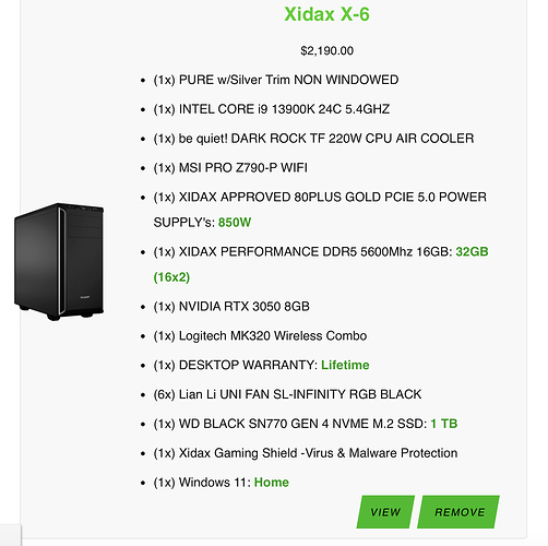

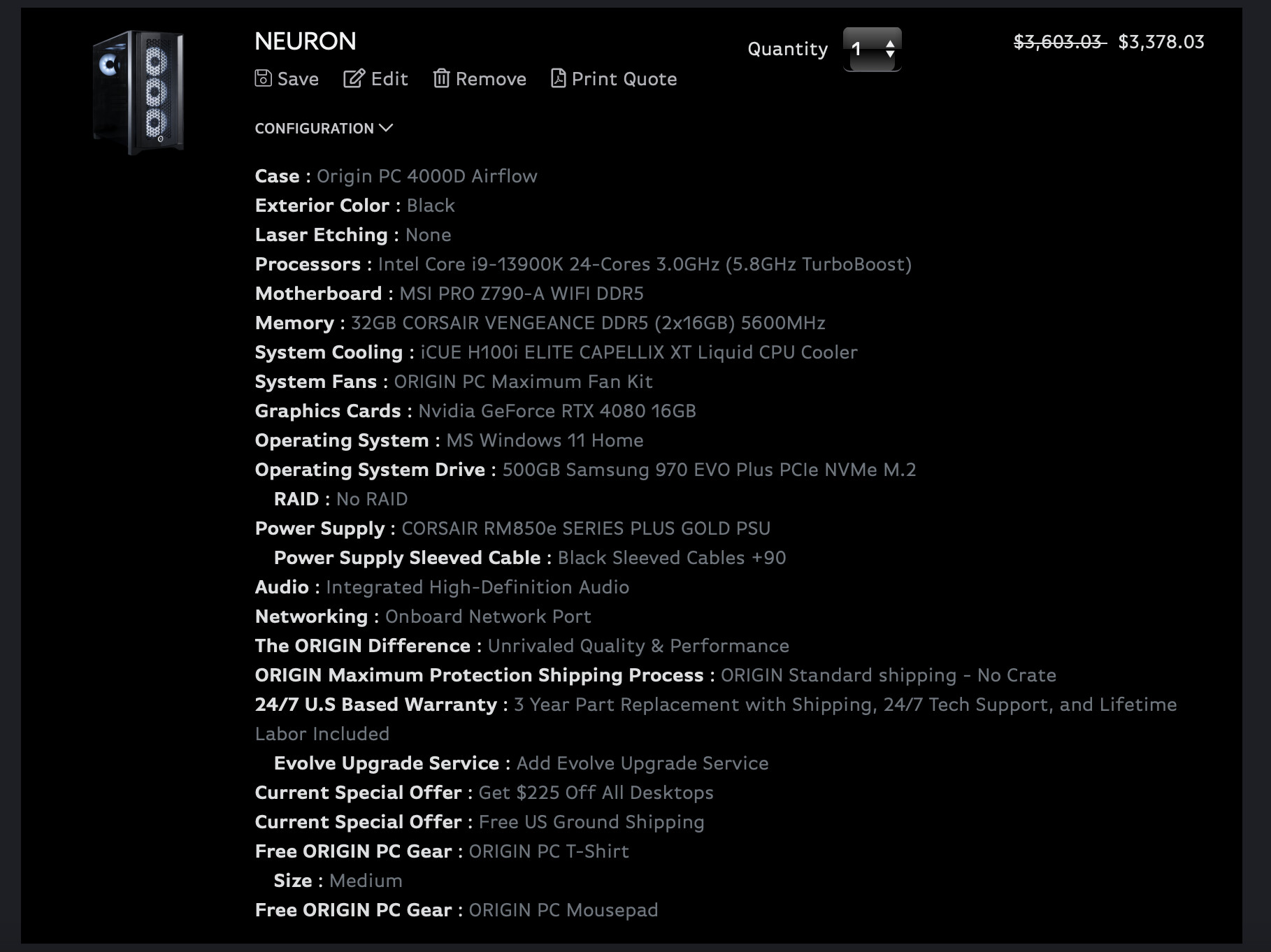

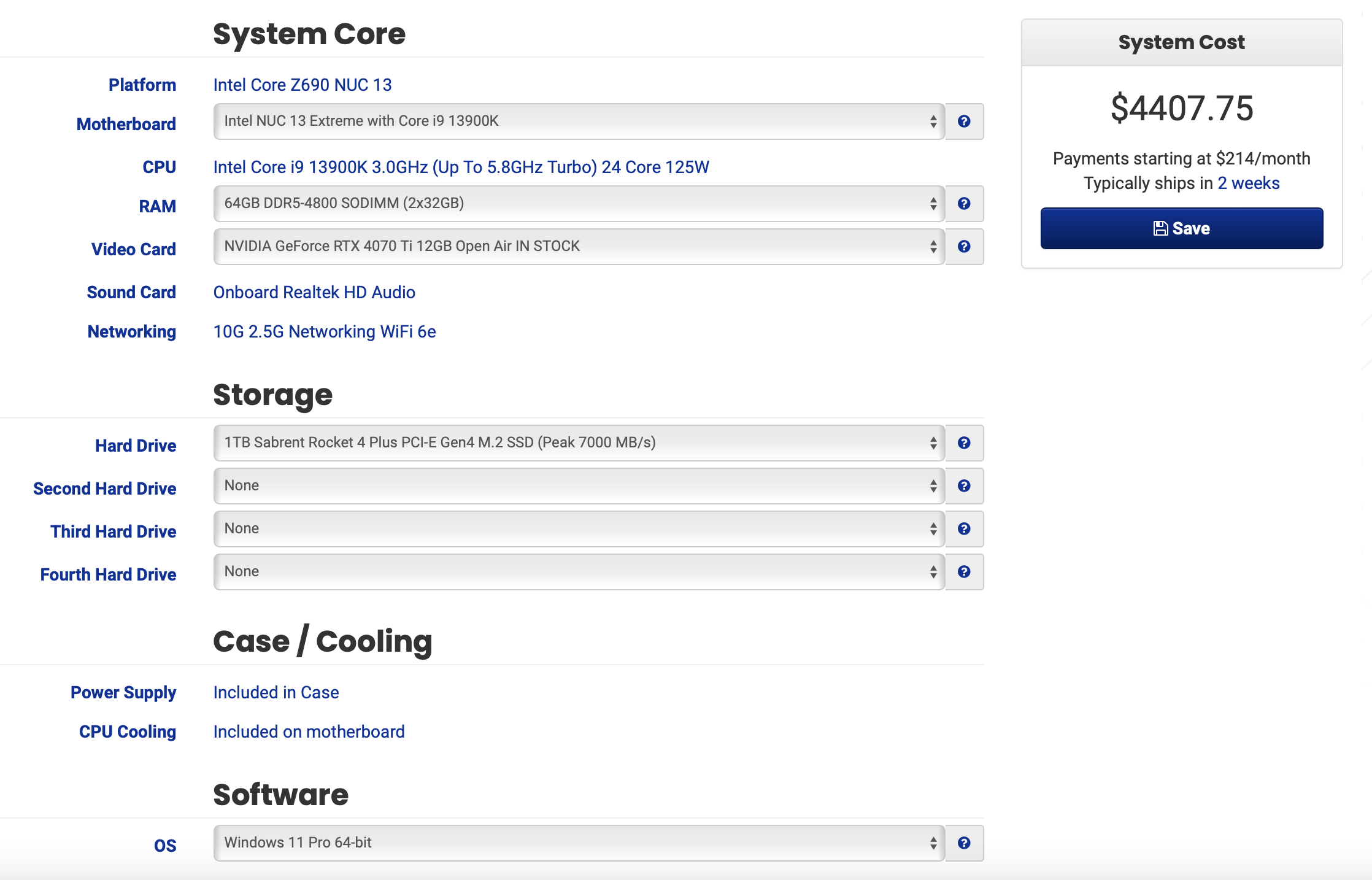

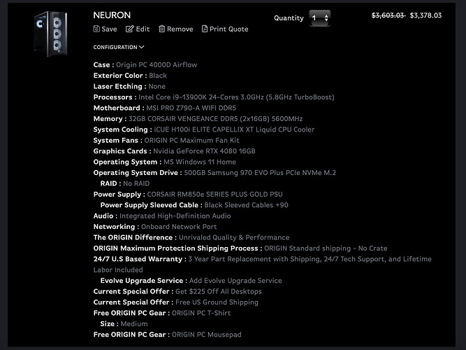

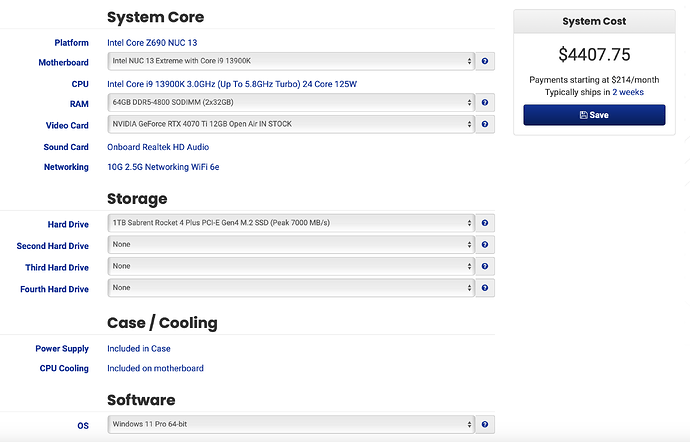

some quotes…help…

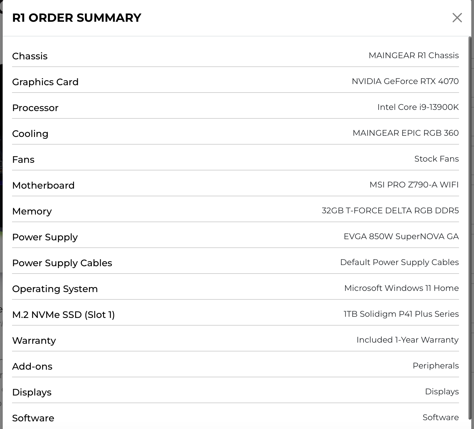

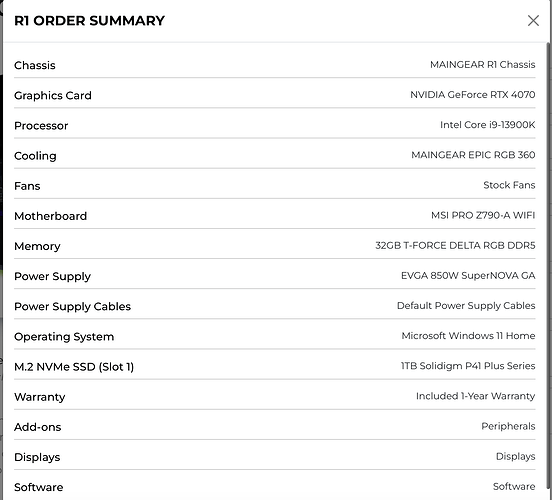

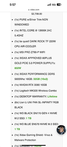

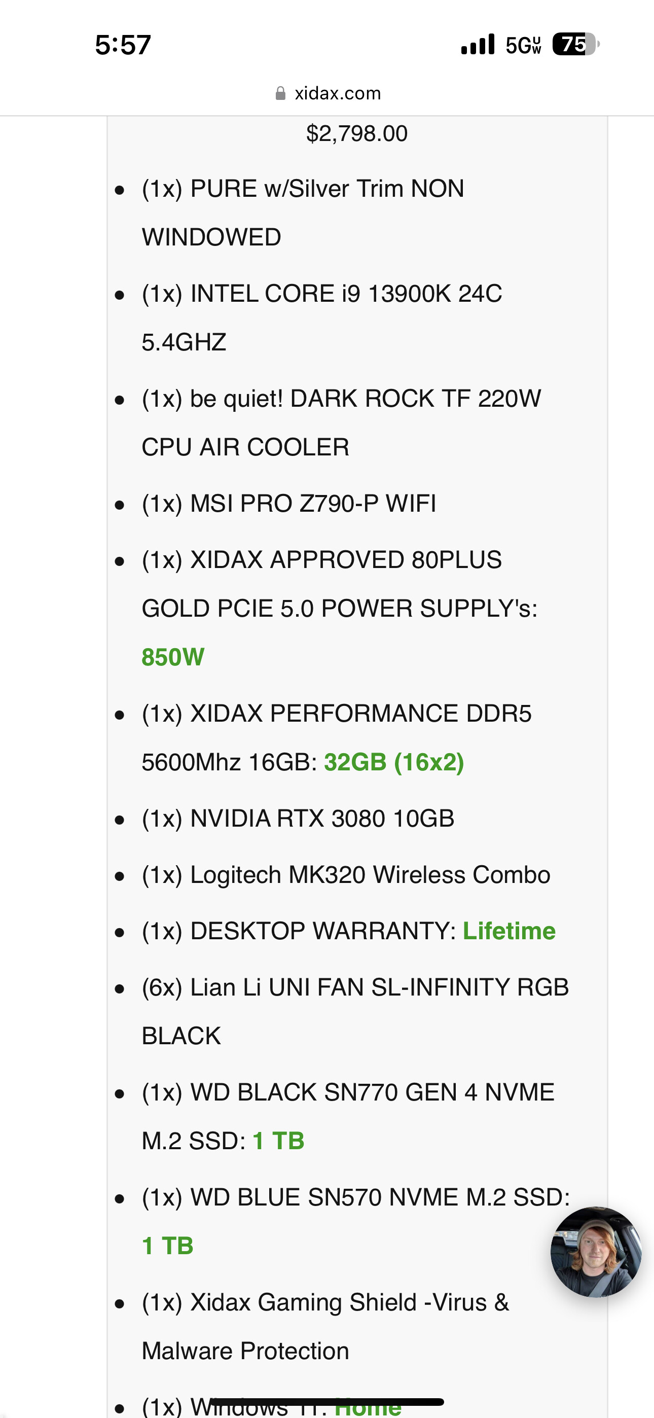

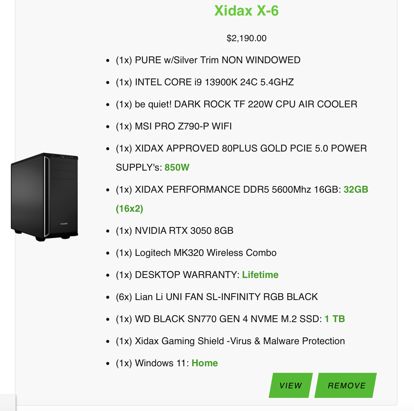

^-^ = $2,832
I assume you are just doing online search?
It’s much better to email the parts list I shared above to a local shop
Those parts prices I shared are all from quick Amazon search
What you have above are some different parts, more expensive
Thx - I’ll try but I’m having difficulty with local shops.
The prices include the GPU so a couple of places I talked with online that are about $2400–$2800 are not far off your estimate.
Yes includes GPU but all different models, so not Apples to Apples comparisons
Actually none of those quotes are really comparable with each other. Different model parts
To keep budget lower recall I suggested 3080Ti - but 4090 probably better buy at the moment but only if budget allows
