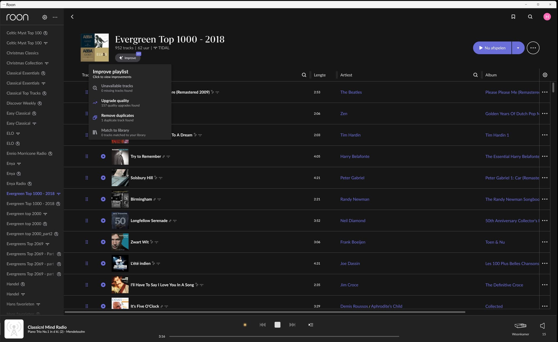

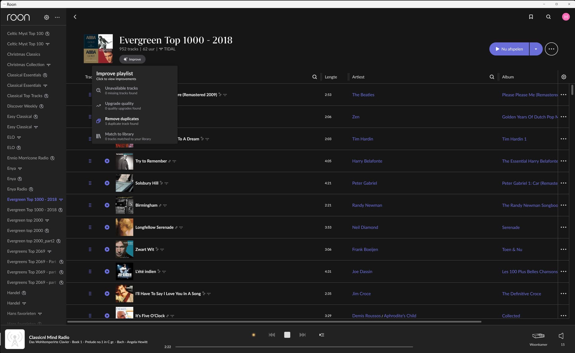

Here are the screenshots.
One at startingpoint, one after the improvement end one few seconds after saving the inprovements.
The same playlist at Qobuz did the job perfectly. Tidal doesnt.
I am curious about Roon’s analysis of these screenshots! And I am also curious if someone can explain why performing the same actions on the same playlist makes the “Improve-button” disappear on the Qobuz playlist screen and endlessly comming back with the same improve suggestions on the same Tidal playlist. Who…?
