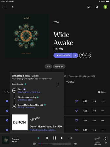

With me, Roon is unable to play a queue without interruptions....
After an earlier trial, I took the plunge and signed up for a one-year subscription. Unfortunately, it is proving to be a disappointing experience to this point.
My setup:
Roon server running on a Synology DS918+ NAS. Now in a docker, but I've also tried the separate app (.pkg).
Marantz SR8015 AVR.
In two rooms a Denon Home Sound Bar 550 .
In the bathroom Denon Home 150 .
Gigabit internet connection.
All equipment ethernet connected with CAT5e or CAT6 cables, except the Denon Home 150
I don't use any of the MUSE settings, the only thing enabled is sound normalisation.

The random stopping of the queue, which sometimes resumes after x-minutes and usually not at all. Regardless of where the music is being played at the time. This always happens when playing music from my library, all flac files. Most 16bit, sometimes a higher bitrate. But also when playing a queue with TIDAL, although less frequently.
I have read more posts on this forum about this problem and usually the cause is dedicated to a bad network connection. That cannot be the culprit in my case.
Also, the Synology has enough memory and the processor does not have to work hard during music playback I see in the user interface.
At the moment, it's a mystery to me why ROON can't keep playing normally, while playback via, say, Plex Amp or directly via the TIDAL app is completely trouble-free.
Have I spent my money on something that is not quite ready? I had a higher expectation of ROON and, as I said, I am hugely regretting my purchase at this point.
What could be the problem here?
Edit: This morning I started a playlist and the issue occurred straight away. I have that part of the log available. I don’t see an option to upload it here, so let me know how you want to receive it.
Edit2: And also the part of the log where TIDAL playback suddenly stopped is available.

I see a lot of AirPlay activity in there. Are you playing to your Denon Home 150? Is it using RAAT or AirPlay?
Read this for more - it sounds like that device is not really using RAAT, but I am not an expert on this…
I am just a user like you, and I understand it is frustrating that Roon might not be good at supporting all AirPlay devices. It would be really interesting if you could find a way to just play some music through RAAT and see if the problem remains…
Most of the time I play to the Denon Home Soundbar 550. They are not ROON Ready (yet). I hope they will at some point. My Denon Home 150 is in the bathroom. I’ll see if I can change my setup to test with it. It does look like it uses RAAT.
I tried the RHEOS extension that makes them appear as Squeezebox Devices, but presents the same issue at some point.
