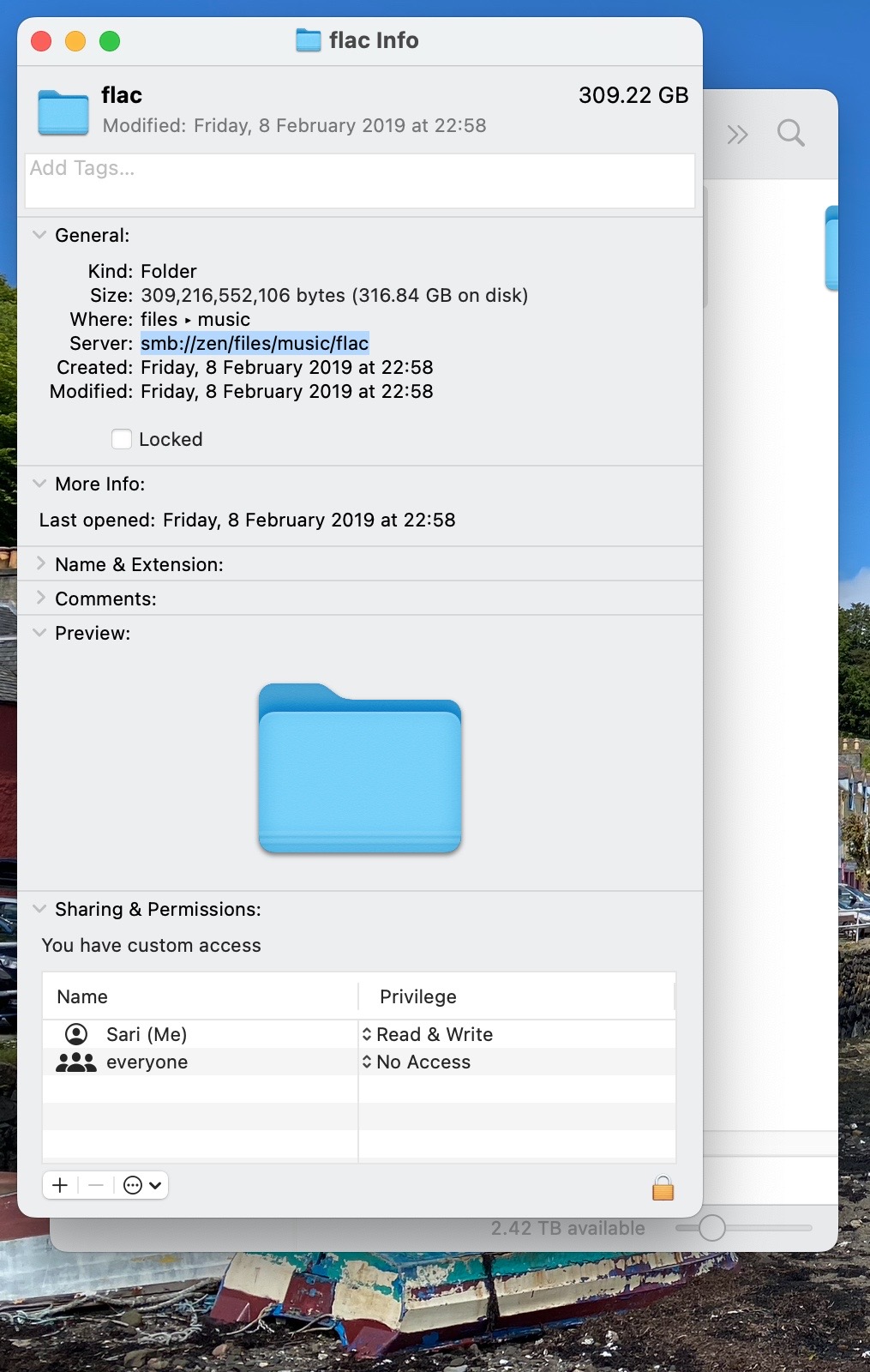

Yes that’s the Zen, I’ve used the ip address and copied smb:zen/files/music/flac as advised, and still getting the same message Invalid network path specified. I’ve now tried everything suggested above, permissions and configurations. I have no problem seeing the zen nas on my mac or listening to it via my Naim steamer. And it used to work just fine with Roon, so don’t know what’s changed now.

Ben here following up on your thread. I see from the screenshot you’ve included above - what happens if you grant ‘everyone’ read & write access?
With that, have you tried filling out the username and password as well as the network path?
In your Mac sharing settings, when you have your folder selected, click ‘options’ and make sure ‘Share files and folders using SMB’ is checked:

You can’t do that the share isn’t from the Mac it’s on the Innuos Zen which he is showing as an example of of the path.

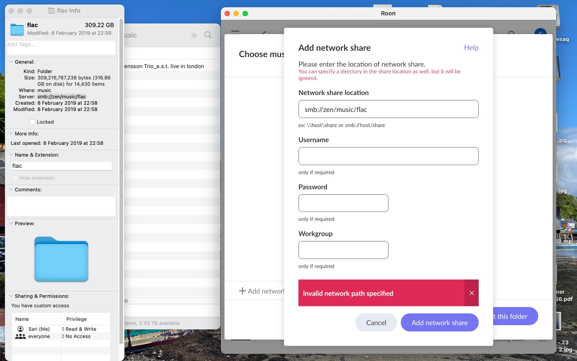

If so, then I’m not sure what the relevance of the Mac screenshot is. It would be more helpful if you were to post a screenshot of the Nucleus “Add network share” screen so that we could see the format of the network address that you are using, and the username and password fields. Thanks.
Hi Geoff, yes you are correct in what I’m trying to achieve. Here is the screenshot.
And just to add, I’ve put used anything on the username/password. If I have to, where would I find the username?

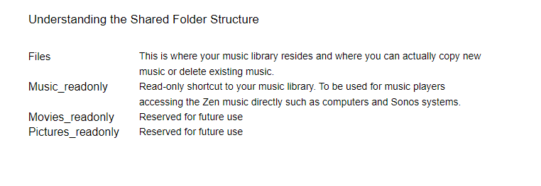

The next page of the manual has this:
So shouldn’t the network address be:
smb://zen/Music_readonly or
\\zen\Music_readonly ?
I tried both of those, with same result… invalid network path
